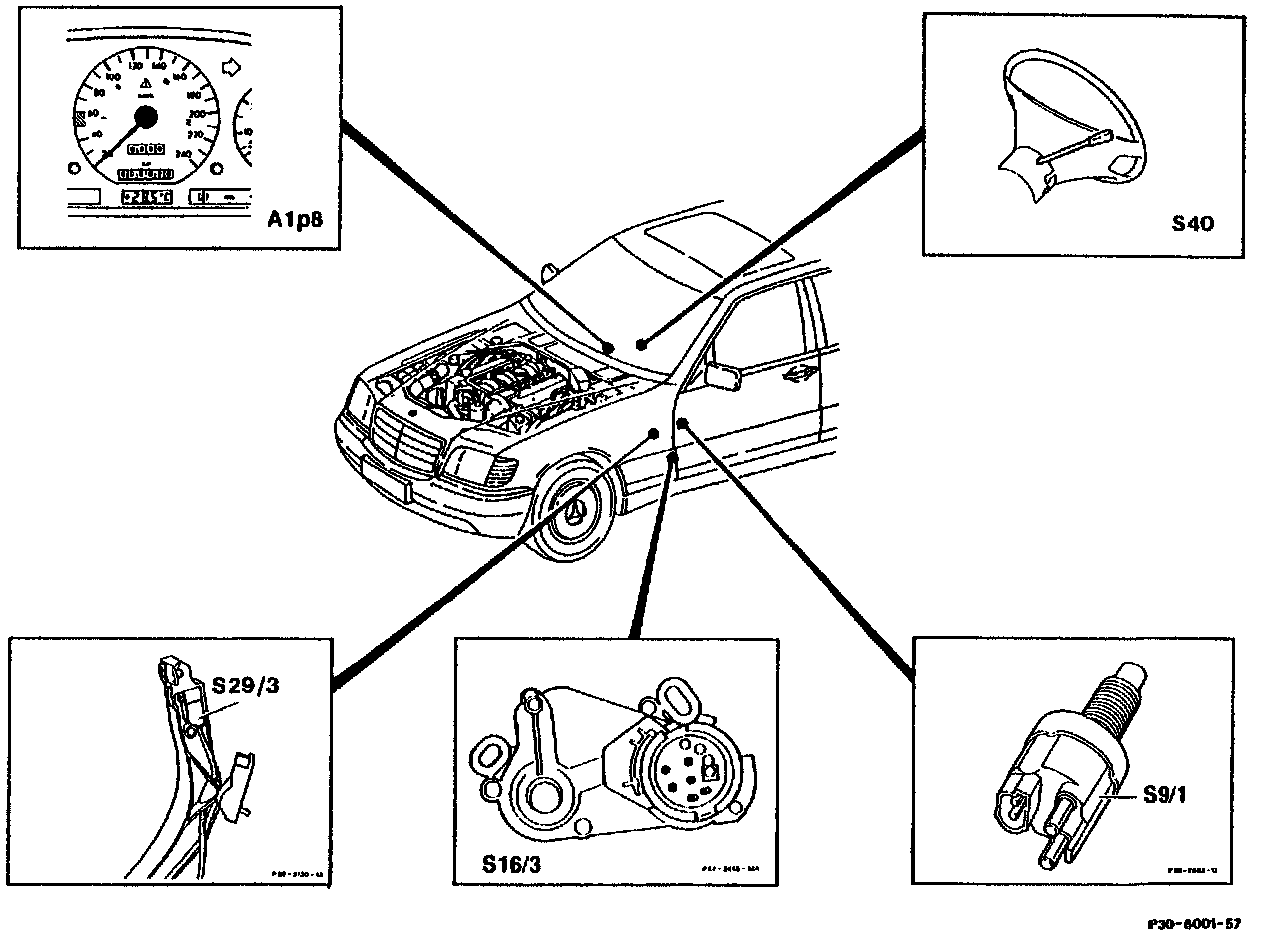

Electronic Accelerator System (EA/CC/ISC)
M16/1 Electronic accelerator/cruise control actuator
N3/1 LH-SFI control module
N4/1 EA/CC/ISC control module
N16/1 Base module
N30/1 ABS/ASR control module
N59 Diagnostic module (OBD 1)
X11/4 Data link connector (DTC readout)
V2 Engine rpm increase diode matrix (right footwell, model 140 with engine 119 only)
A1p8 Electronic speedometer
S9/1 Stop lamp switch (ASR) (4-pole)
S16/3 Starter lock-out/backup lamp switch (transmission range recognition)
S29/3 Closed throttle position switch
S40 Cruise control switch
V Decelerate/set
B Accelerate/set
SP Resume
A Off
