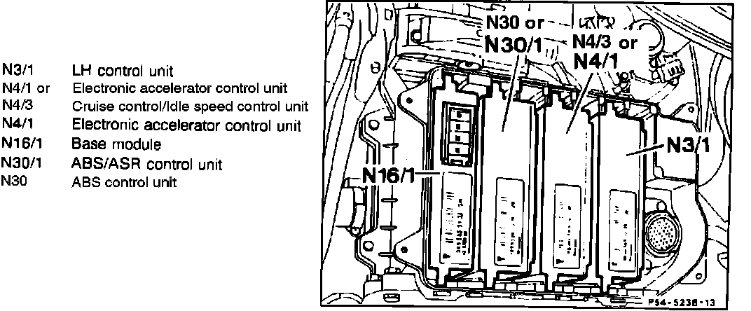

NOTE: This information is valid only for control modules located in the module box (F23).Control Unit Arrangement In Module Box (F23):
CONTROL MODULE ARRANGEMENT
The individual connection fields in the module box are identified by numbers. This, along with color coded connectors, allows for easy coordination of the wiring harness with the respective connection field and control module.
Control Unit Color Code Location:
CONTROL MODULE COORDINATION AND I.D.
A color code identification mark on each control module is identical to its respective connector in the module box.
Control Unit I.D. Chart:
I.D. AND LOCATION CHART
