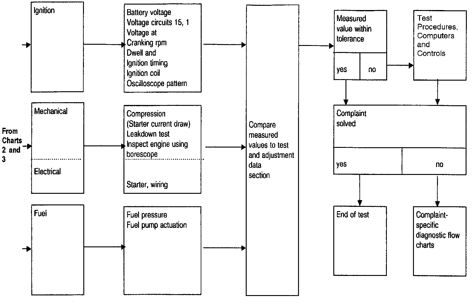

Chart 1:

Chart 2:

Chart 3:
AT CRANKING AND AT IDLE RPM
Chart 4:
