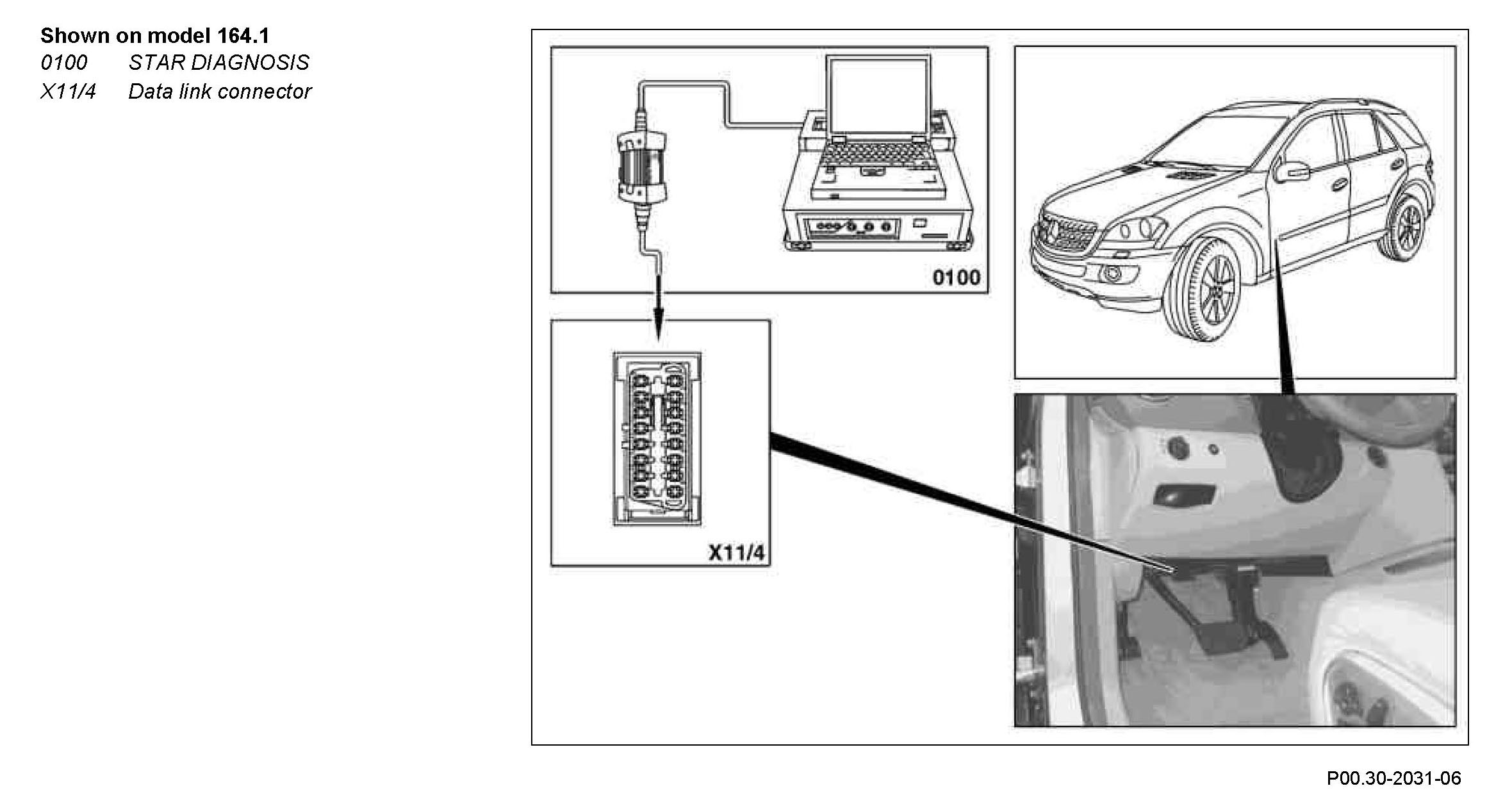

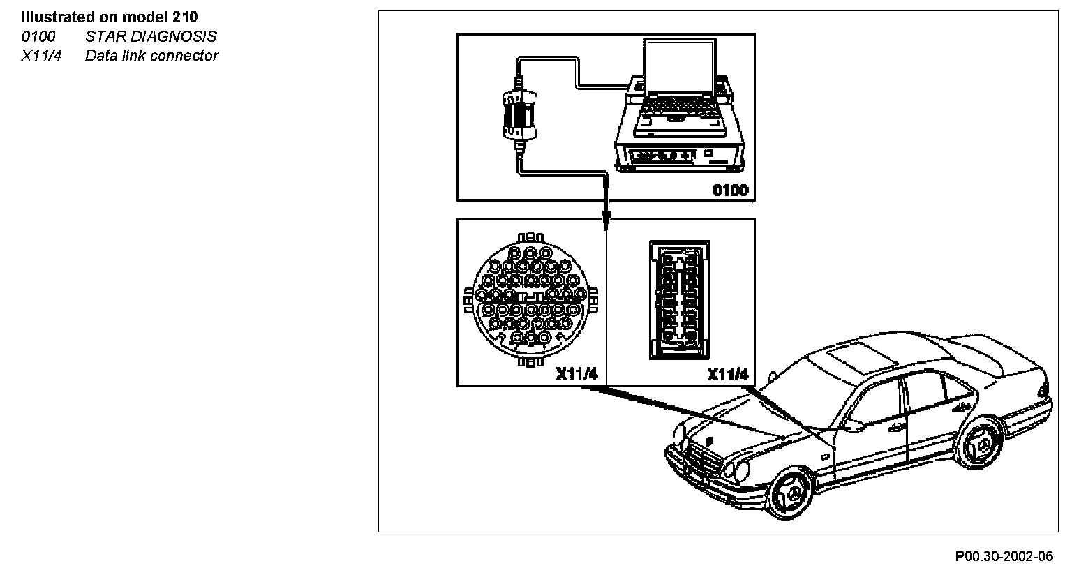

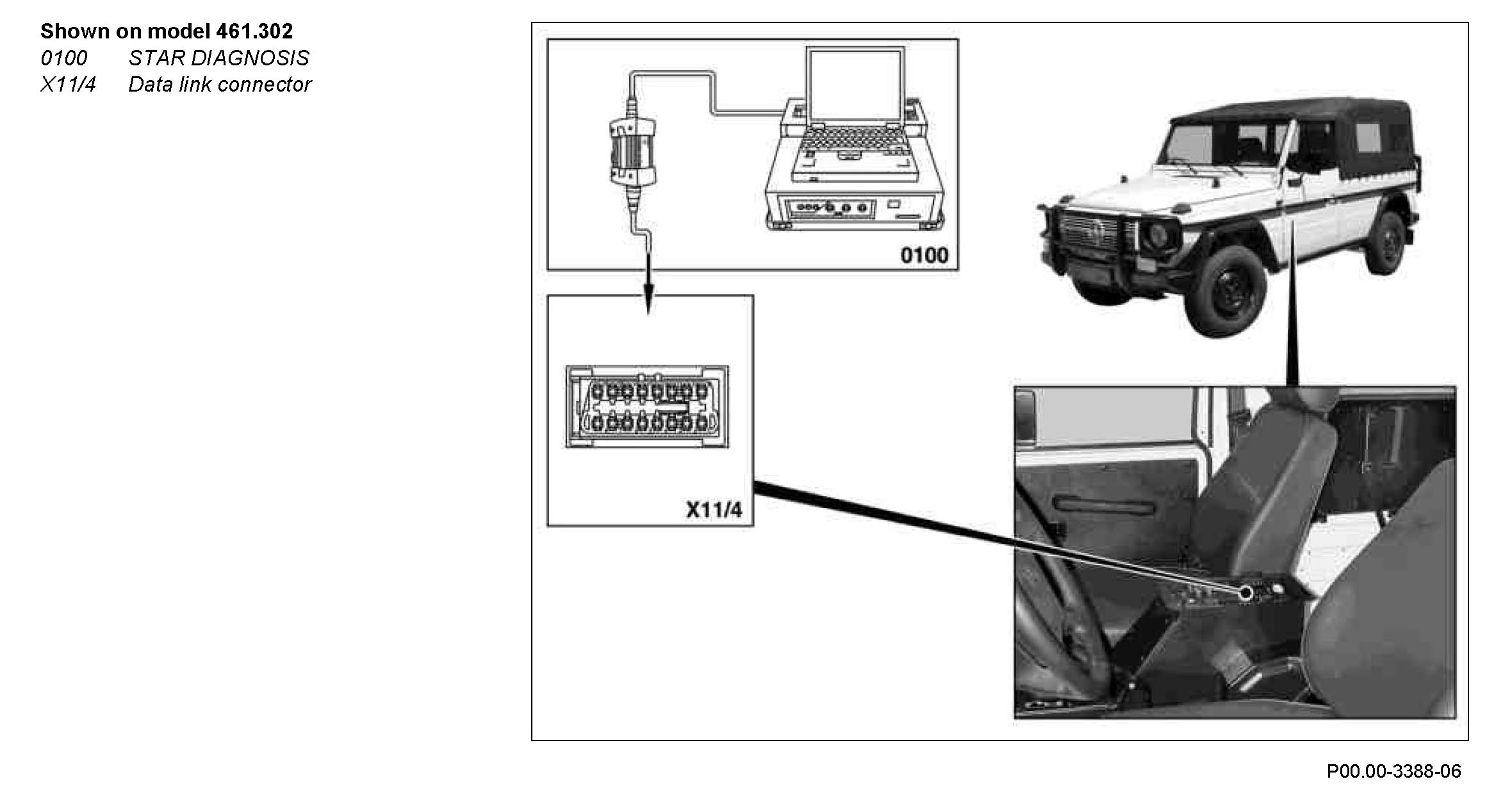

1 Connect STAR DIAGNOSIS (0100) to diagnostic socket, on the data link connector (X11/4) or on the data link connector (1.3) (X11/22).
2 Switch on ignition.
3 Start the Diagnosis Assistance System.
4 In the "Model" menu, select the sub menu "Other model series".
5 Go through the instructions on the screen:
^ Enter the control unit version
^ Read out fault memory and erase
^ Readout actual values
^ Perform actuations
^ Adaptation of control units
6 Disconnect STAR DIAGNOSIS (0100).
Stored faults which may be caused by disconnecting cables or by simulation during testing operations must be deleted in the diagnostic trouble code memory following completion of the operations.
