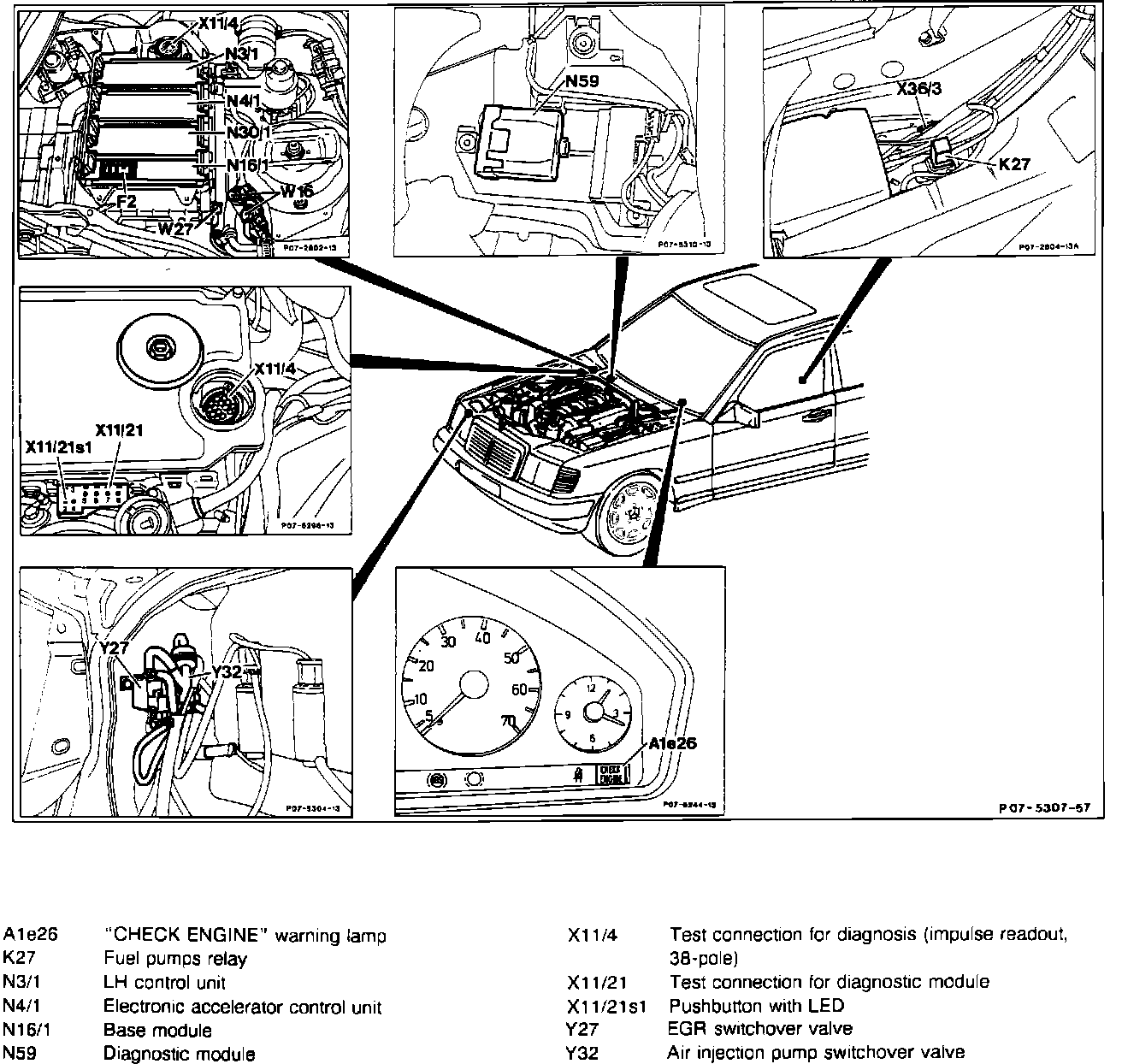

Fuel System Locations:
AIR INJECTION PUMP SWITCHOVER VALVE (Y32)

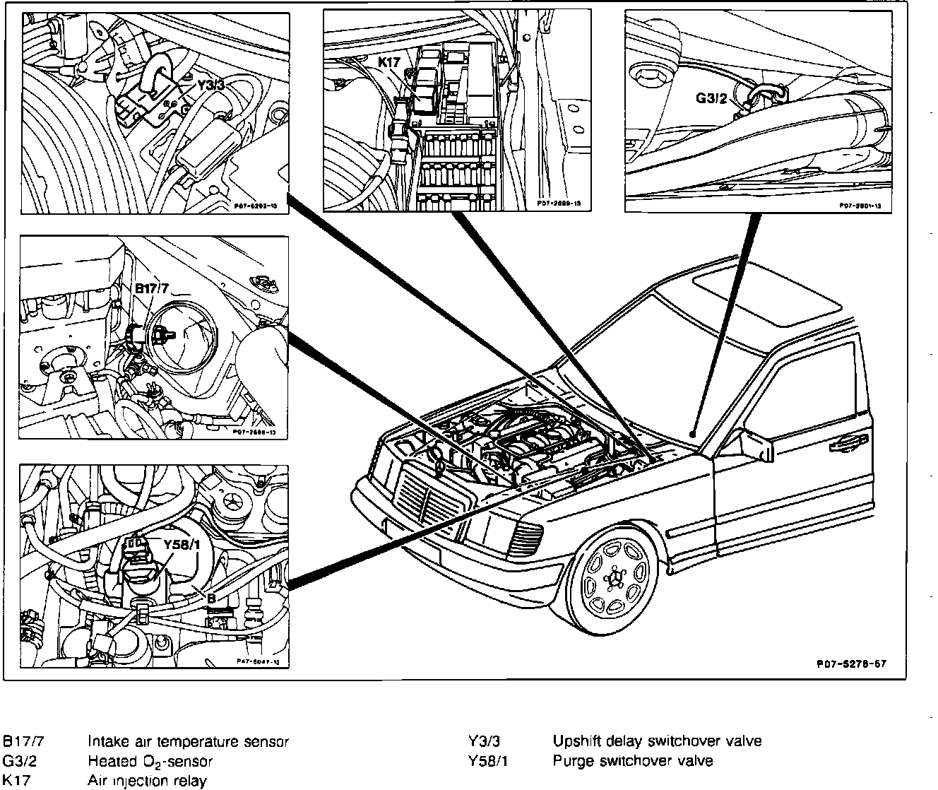

Component Locations:
AIR INJECTION RELAY (K17)
