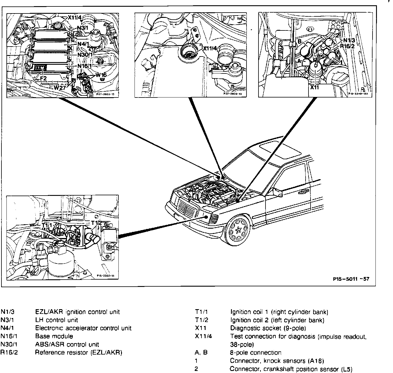

The EZL/AKR ignition control module (N1/3) contains a microcomputer, pressure sensor and the power output stage for control of the two ignition coils (one per cylinder bank).
Component Locations:
LOCATION
It is fitted to the driver side wheelhouse and is installed with a heat conducting paste.
