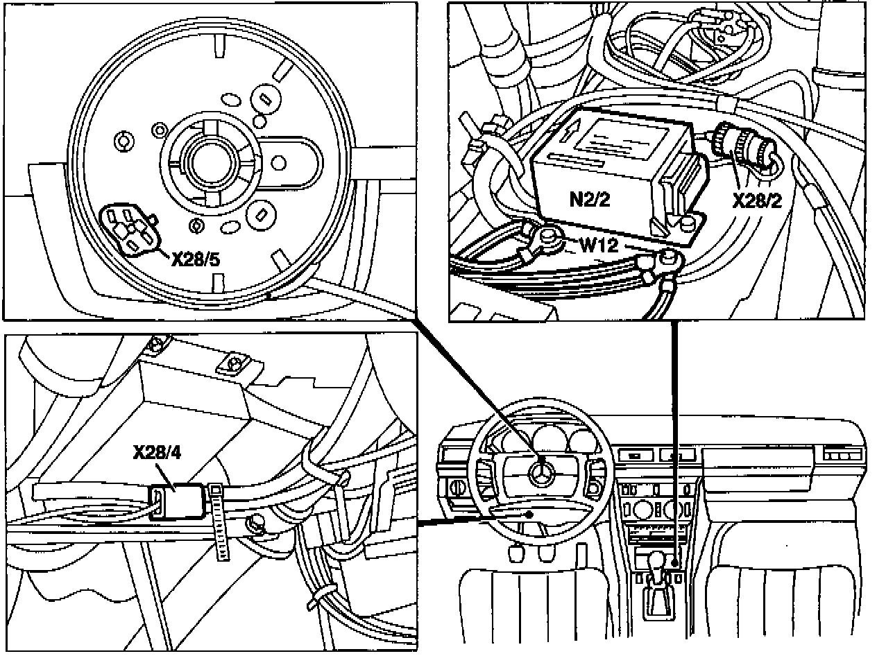

Connector Locations
X28/2 SRS voltage supply connector
X28/4 Driver airbag squib connector
X28/5 Airbag squib slip ring

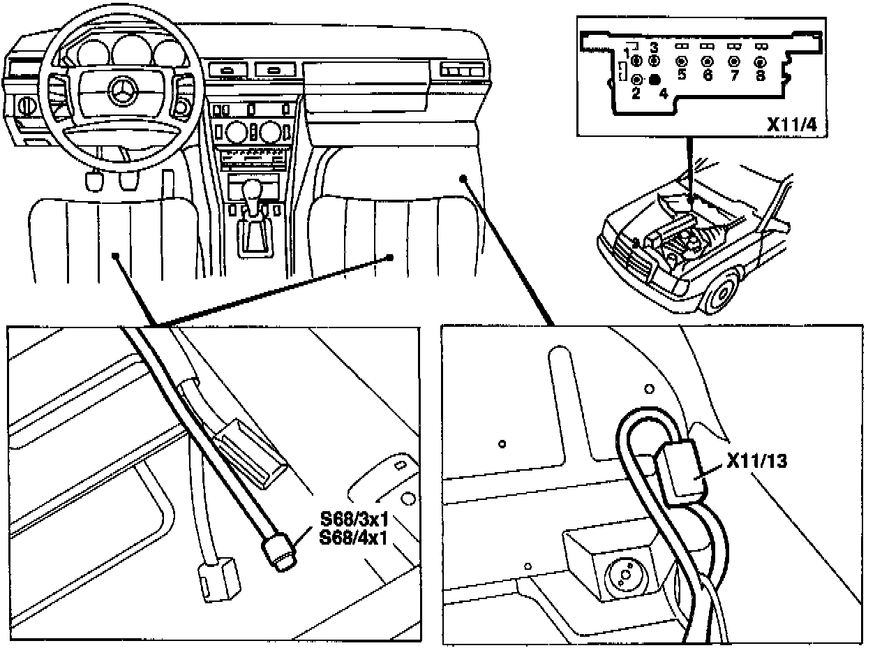

S68/3x1 Left front seat belt buckle switch connector
S68/4x1 Right front seat belt buckle switch connector

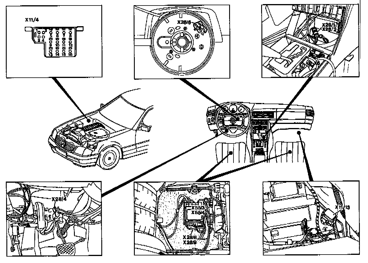

X11/4 Data link connector*
X11/13 ETR test connection*
X11/4 Data link connector (DTC readout)*
X28/1 ETR voltage supply connector
X28/8 ETR connector (left seat plug connection)
X28/9 ETR connector (right seat plug connection)
X55/3 Left seat contact strip
X55/4 Right seat contact strip
* Be advised, X11/13 and X11/4 were previously identified as X29/9 and X92, respectively. Identification of both of these connectors has been changed and as a result there may be references to either in the repair and testing information.
