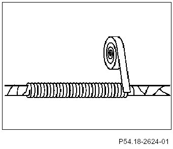

Protection of repair point by wrapping round fabric tape.
1 Wind fabric tape around the repair point as per the original condition.
Primarily fabric tape is used for the visual adaptation of the repair point and to protect against chafing. In vehicle areas with higher loads (e.g. engine compartment), fabric tape should only be used in combination with other (watertight) safety measures.
