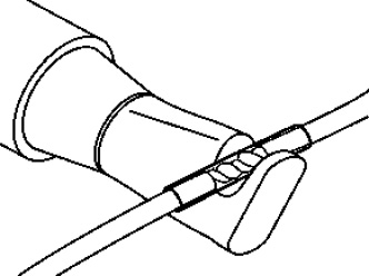

8 Heat up axial solder connector with a preheated hot air blower (with electronic temperature control) to 400 °C.
Hot air blower gotis://E_15/54_12.0
Use welding bead catcher in the vehicle interior in order to avoid damage due to liquid solder.
Until the soldering ring has dissolved and the covering has positioned itself properly around the lines.

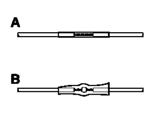

9 Check soldered point.
It must not be possible to see the soldering ring of the axial soldered connector any more. The covering must contact the lines properly.
A Correct
B Incorrect
