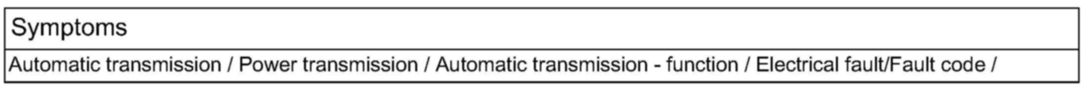

Symptoms

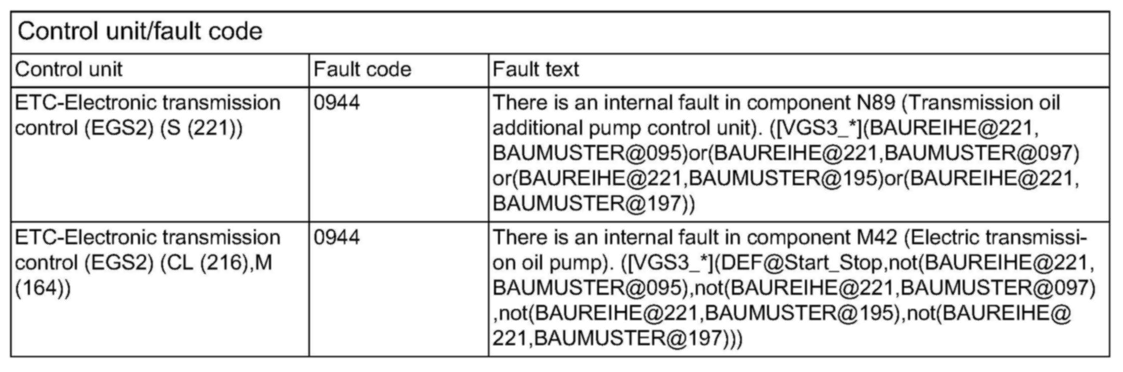

Control unit/fault code

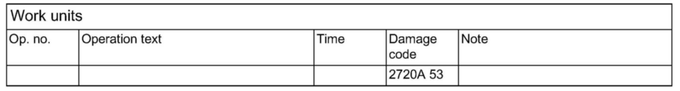

Work units
