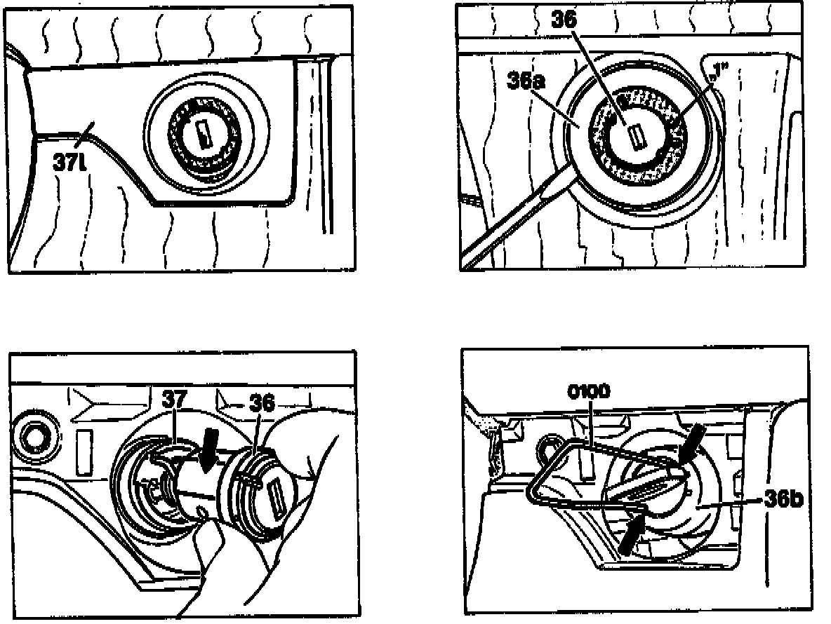

Removal of Lock Cylinder:
- On model 124, remove cover (37l) from the instrument panel.
- On model 201, remove escutcheon (36a) using a small screwdriver.
- On model(s) 124 or 201, turn lock cylinder (36) into position "1" with key.
- Press disengaging wire (0100) into the bores (arrows) and unlock the locking detents by overcoming the spring resistance.
- Remove lock cylinder (36) with cap (36b) from steering lock (37).
- Remove key and disengaging wire (0100) from lock cylinder (36), remove cap (36b).

- Install lock cylinder (36) in the cap (36b), push in key and turn into position "1". Press lock cylinder (36) into the steering lock with key and cap (36b) until the cap (36b) engages (observe groove assignment).
