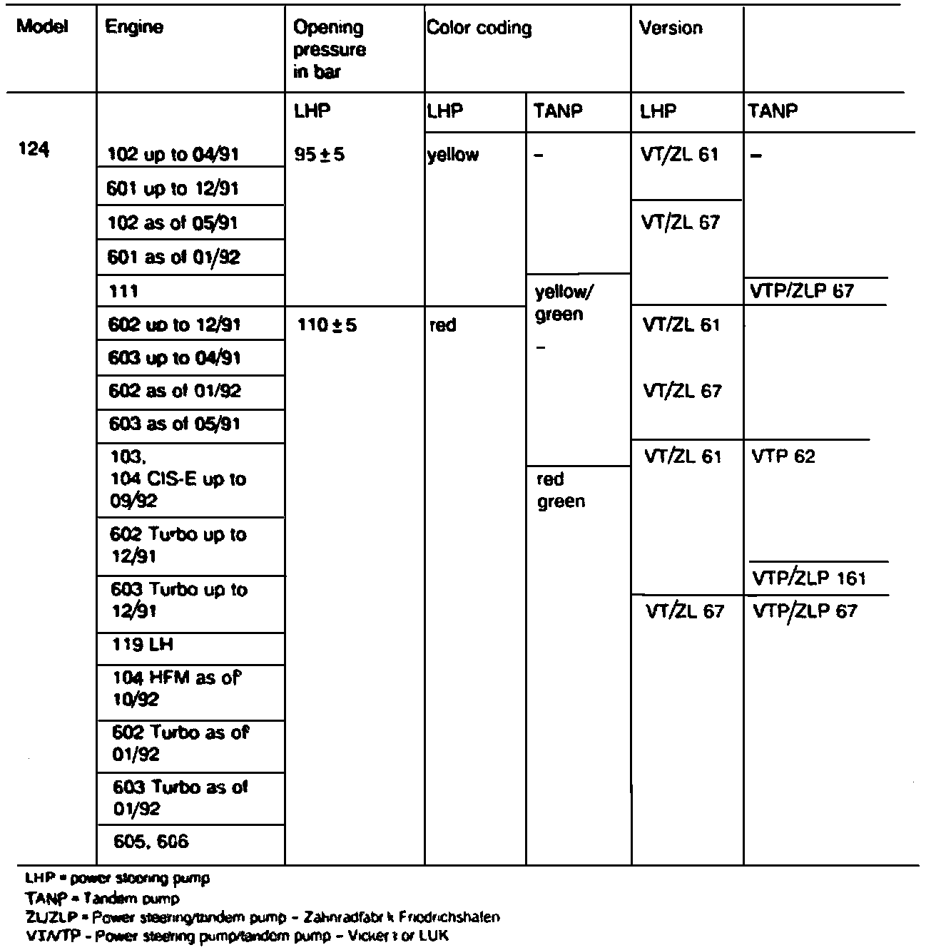

Power Steering Pump: Application and ID
Application and ID
LHP = Power Steering Pump
TANP = Tandem Pump
ZL/ZLP = Power Steering/Tandem Pump - "Zahnradfabrik Friedrichshafen"
VT/VTP = Power Steering Pump/Tandem Pump - "Vickers or LUK"
Model 124:
Models, 202/201/140/129:
NOTE: Tandem pumps on vehicles with level control, 4MATIC, ASD, ADS. The pressure of the radial piston pump section (approx 150 bar) in the tandem pump is limited in the control units of the connected systems.
