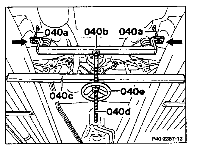

Pull vehicle rear end down with pulling device 201 58911 31 00
Vehicles without trailer hitch
Hook pulling device (040b) with mounting bolts (040a) onto rear mount for rear axle carrier and lock in place (arrows). Attach lower cross member (040c) with pulling spindle (040d) to pit or lifting platform.
Vehicles with trailer hitch
Hook pulling device to trailer hitch with two additional chains (041) through inner eyes in trailer hitch. Attach lower cross member (040c) with pulling spindle (040d) to pit or lifting platform.
