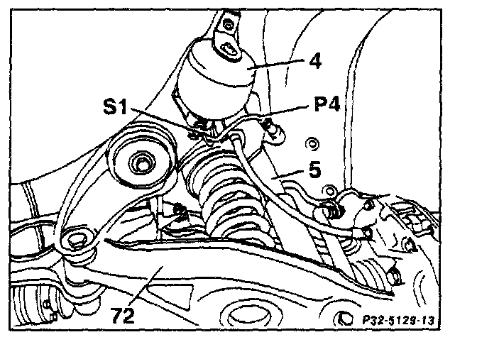

The spring strut (5) is attached to the spring link (72) below and the dome of the frame floor above. The spring strut (5) is connected via the pressure line (P4) attached to the top of the housing to the accumulator (4) attached to the frame floor.
The accumulator is in turn connected to the level control unit by the pressure line (S1). Lifting of the lowered rear end of the vehicle is achieved by increasing the oil quantity in the oil chamber of the spring strut, which results in extending the piston rod. The mechanical layout of the spring strut (5) is similar to that of a normal shock absorber.
