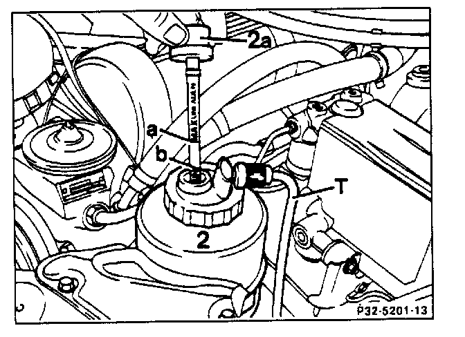

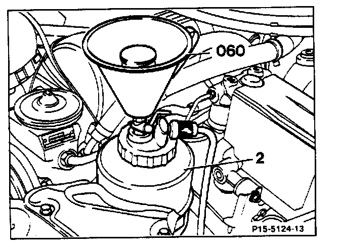

Oil reservoir (2):
fill hydraulic oil into oil reservoir (2) using funnel 126 589 12 63 00, until oil level is between the "min" and "max" marks on the oil dipstick.

Oil level:
check oil reservoir. The oil level must be between the "min" and "max" marks when engine is not running.

3 Use funnel with screen (060) to add oil to oil reservoir (2).

4 Check oil level in oil reservoir (2) and top off if required. The oil level should be approximately at the maximum marking (a) for filling the system when the spring struts are empty.

Model 124 in bore "b"
7 Check oil level in oil reservoir (2) when engine is not running and correct if necessary. When the system is operational the oil level should be between the "max" and "min" marks in the ready-to-drive condition. It the vehicle is fully laden the oil level is below the "min" mark (no longer visible on dipstick).
