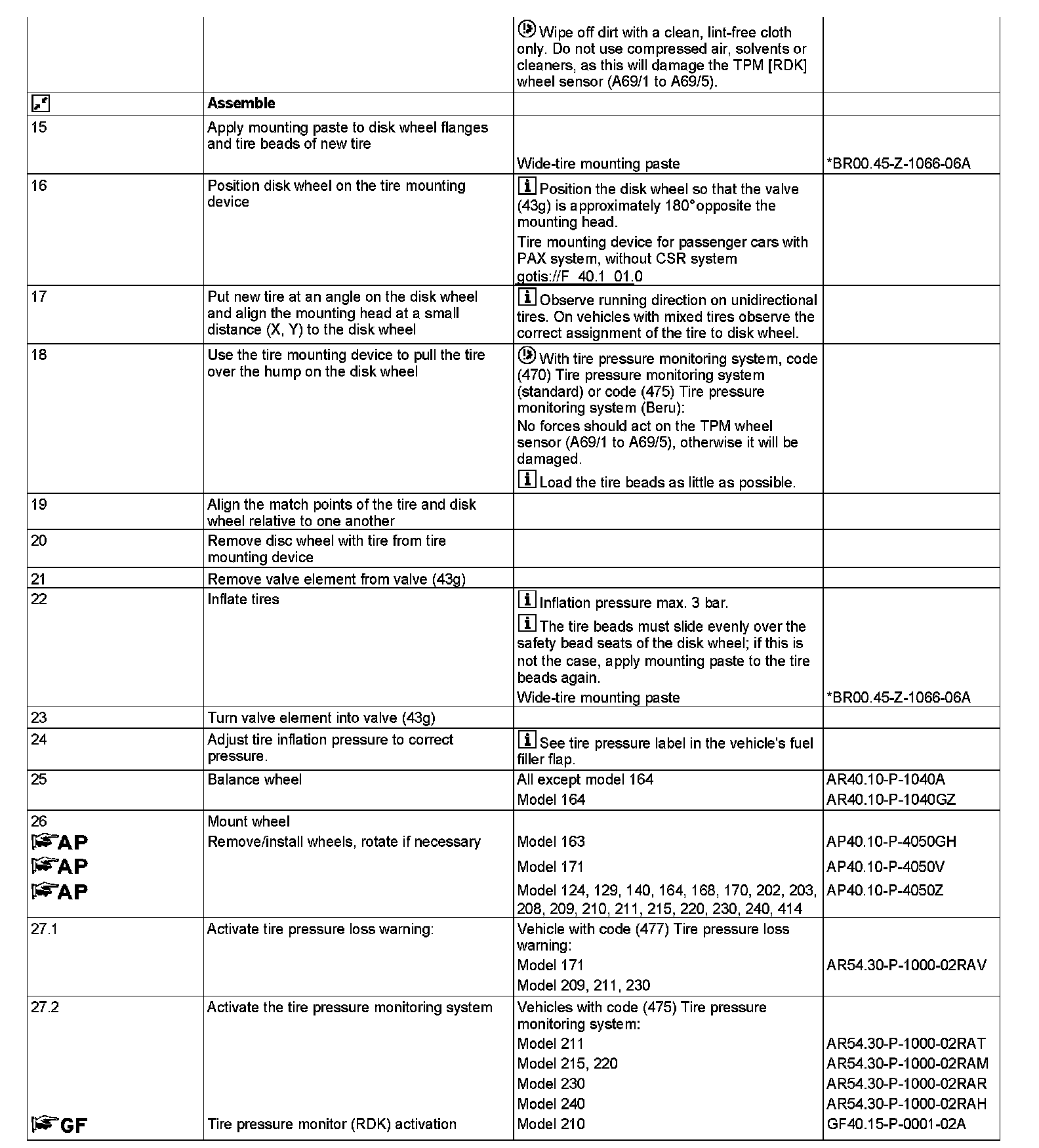

AR40.10-P-1030A Replace Tires

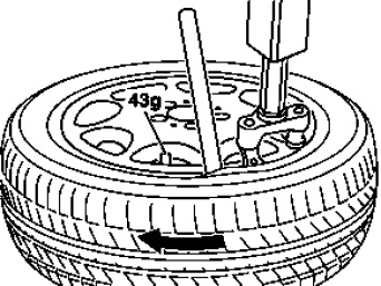

43a Balance weight
43g Valve
X Distance
Y Distance

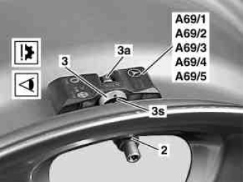

A69/1 Left front TPM [RDK] wheel sensor
A69/2 Right front TPM [RDK] wheel sensor
A69/3 Left rear TPM [RDK] wheel sensor
A69/4 Right rear TPM [RDK] wheel sensor
A69/5 TPM [RDK] wheel sensor for spare wheel (only model 203, 209, 210, 215, 220, 240)

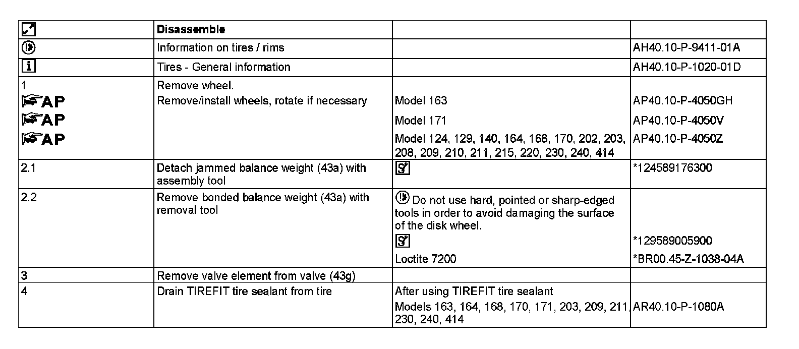

129 589 00 59 00
Removal tool
124 589 17 63 00
Assembly tool
