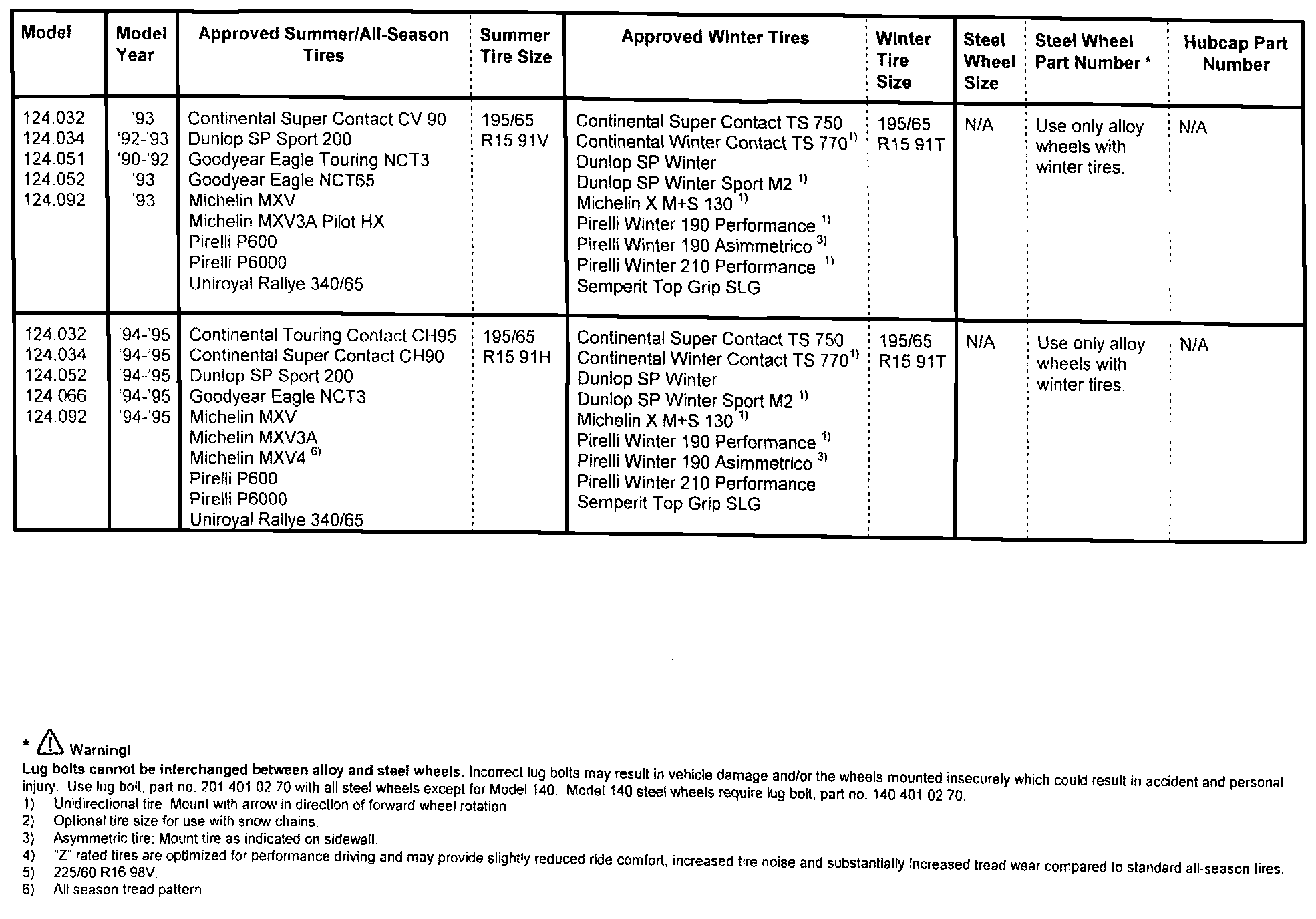

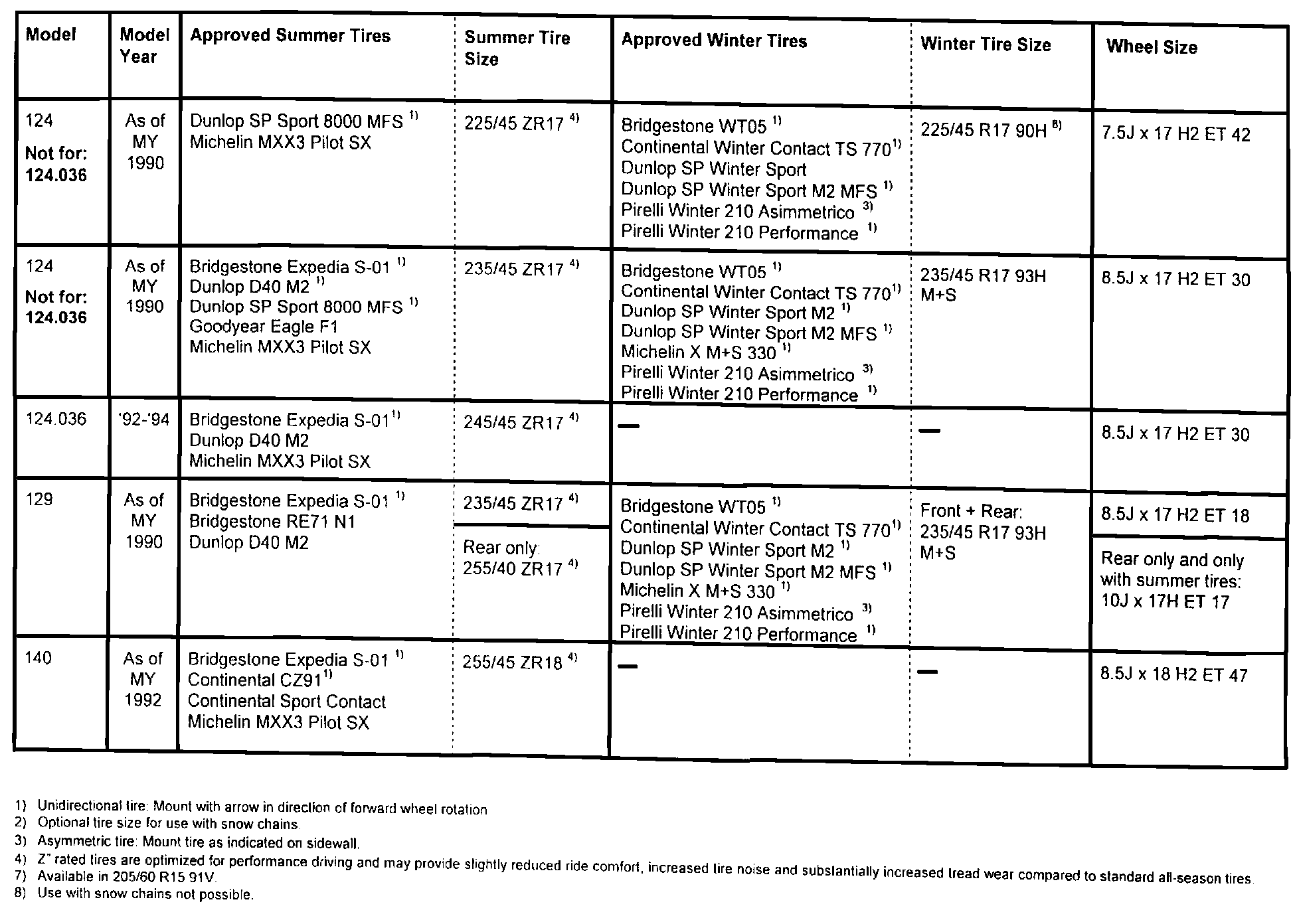

FACTORY-APPROVED SUMMER/ALL-SEASON/WINTER TIRES,
FACTORY-APPROVED SUMMER TIRES FOR ACCESSORY WHEELS
AND STEEL WHEELS FOR WINTER TIRES
This following is a list of summer/winter tires, steel wheels and snow chains currently approved by DaimlerChysler AG for all Mercedes-Benz models sold in the USA/Canada by MBUSA/MBC starting 1986 through 1999. A chart showing the maximum speed ratings is also included.

^ Speed and load ratings for the previous VR tires can be confirmed by the individual tire manufacturer.
^ The tire speed rating symbol "W" has been added to the familiar speed symbols "Q/R/S/T/H/V/VR/ZR". This new symbol is used to designate tires approved for a top speed of 162 mph. When installing new tires, these tires can be used to replace VR and ZR tires, because the affected vehicles have a limited top speed of 150 mph.
Tire Speed Rating
CAUTION!
All tires on the vehicle must be in the same speed rating category. Clients should be made aware of the maximum speed ratings (refer to table). This is especially important if winter tires are installed which have a lower speed rating than the summer tires normally used.
