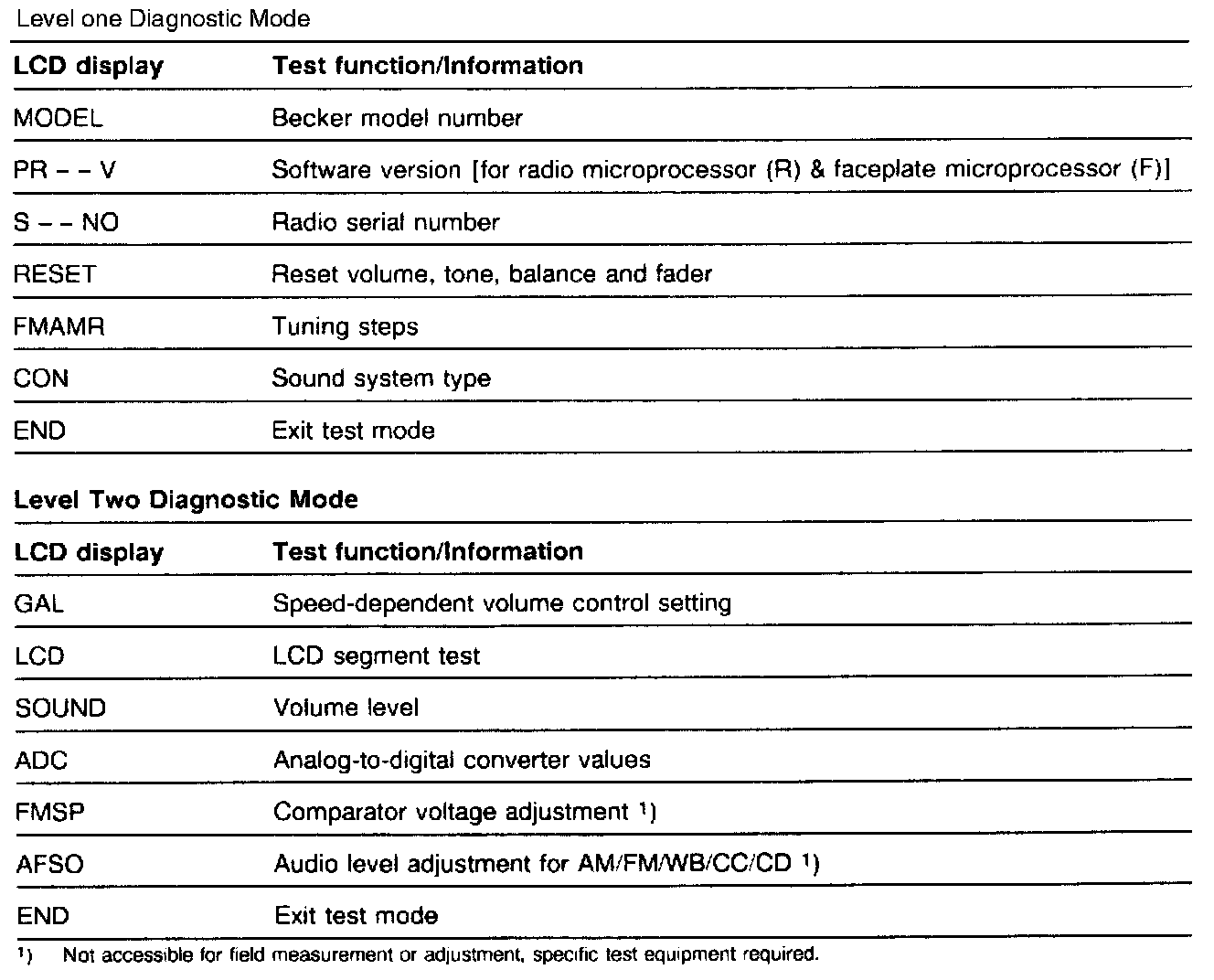

To select the different Test Functions/Information (see table shown) press the seek tuning (SEEK) button (9).
The actual level, numerical value or visual indication for each test function can be accessed by pressing the manual tuning (TUNE) button (11).
Note:
The values for GAL in Level Two Diagnostic Mode change according to vehicle speed.
Example of level one data
Example of Level Two data
