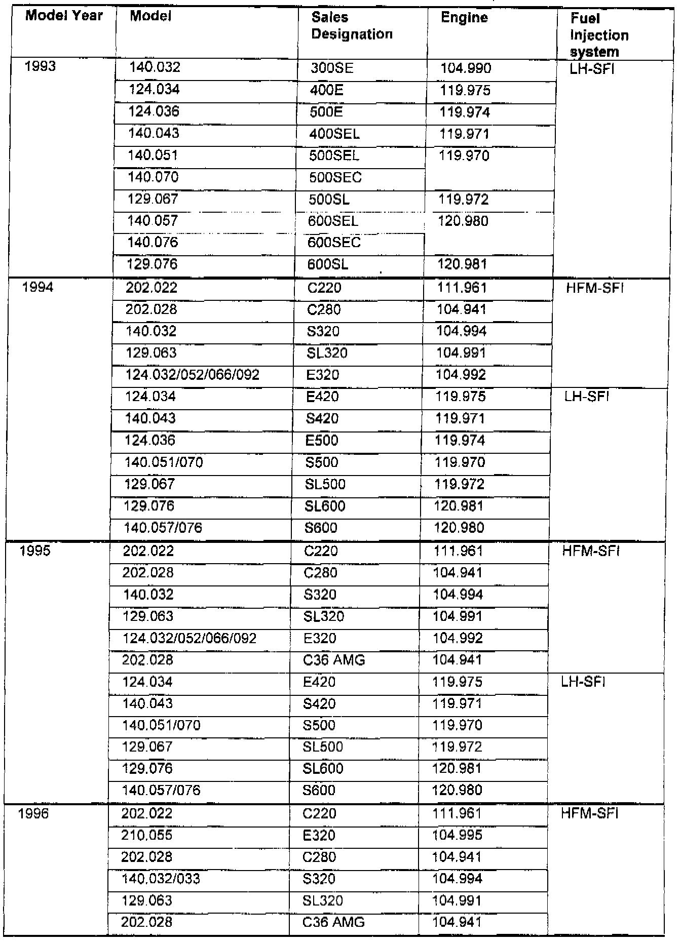

Affected vehicles
This service information pertains to models with LH-SFI or HFM-SFI, model years 1993 through 1996. Please refer to the table shown for a detailed listing of the affected vehicles.
