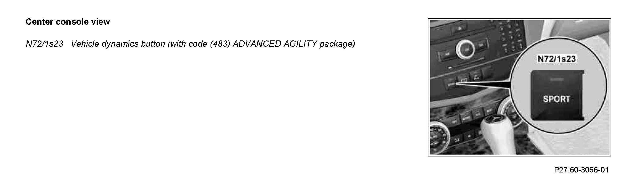

Component Identification:
The driving dynamics button can be used to select a sporty suspension tuning and transmission mode "S" or a comfortable suspension tuning and transmission mode C.
