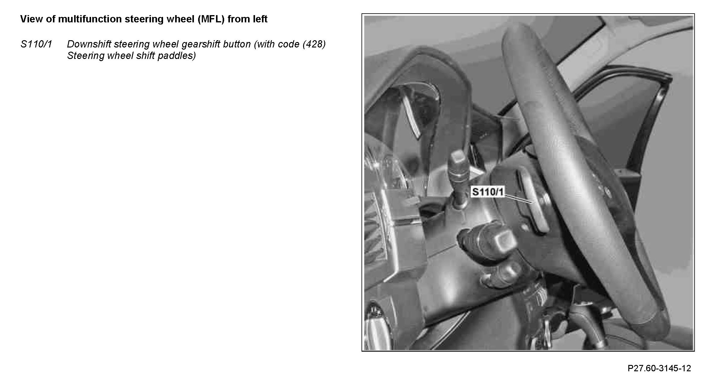

GF27.10-P-0001-08AHW Automatic Transmission (AT), Location of Electric/Electronic Components
GF27.10-P-0001-08AHW Automatic transmission (AT), location of electric/electronic components
- Transmission 722.902/906/907/960/962/963/964/998/999
Component Identification:
The downshift steering wheel gearshift button is located on the left and the upshift steering wheel gearshift button is located on the right on the back of the multifunction steering wheel (MFL) (S111/1).
