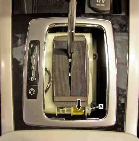

Function sequence of Shift-Lock-Override
View of selector lever module from rear for model 204 up to model year 2011 /YoM 10
A Lever
Should it not be possible to engage a gear range from selector lever position "P" for reason of mechanical or electrical faults, the lock of selector lever position "P" can be released manually.
To do this, the rubber boot on the selector lever cover must be unclipped and, using a suitable tool, pressed through the guide underneath on the lever (A) (arrow). The lock of the selector lever position "P" is released via a pin in the locking solenoid.
The selector lever can be shifted out of selector lever position "P" by operating the lever (A) and selector lever simultaneously.
