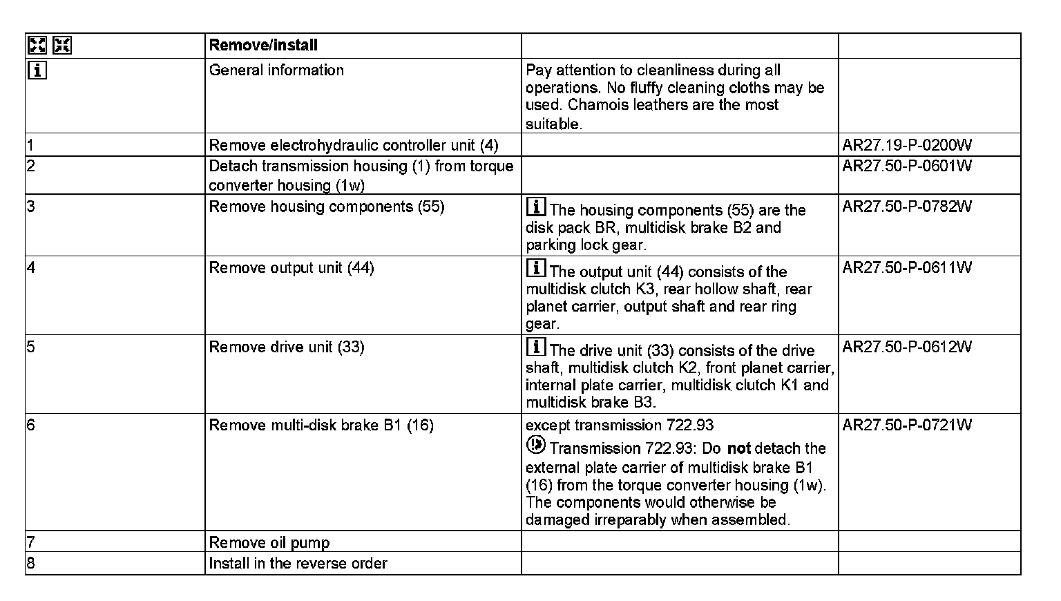

AR27.50-P-0610W Remove/Install Main Components of Transmission

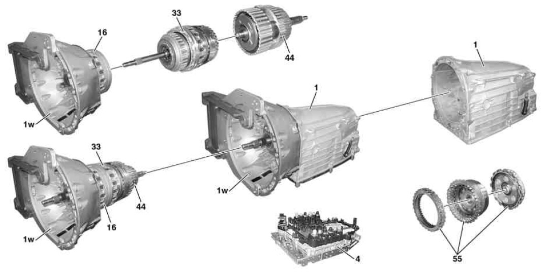

TRANSMISSION 722.9
1 Transmission housing
1w Torque converter housing
4 Electrohydraulic controller unit
16 Multidisk brake B1
33 Drive unit
44 Output unit
55 Housing components
