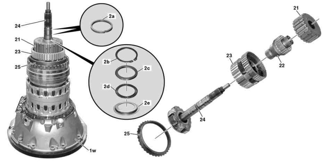

AR27.50-P-0611W Remove/Install K3, Rear Hollow Shaft, Rear Planet Carrier and Output Shaft
TRANSMISSION 722.9
1w Torque converter housing
2a Torlon ring
2b Circlip
2c Shim
2d Axial needle roller bearing
2e Thrust plate
21 Multidisk clutch K3
22 Rear hollow shaft
23 Rear planet carrier
24 Output shaft
25 Rear ring gear
722 589 00 14 00
Sleeve
