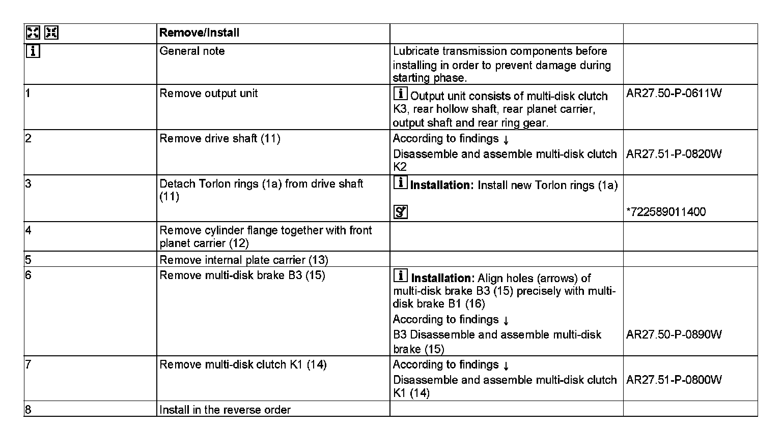

AR27.50-P-0612W Removing/Installing Drive Shaft With K2, Front Planet Carrier, Internal Plate Carrier With K1 and B3

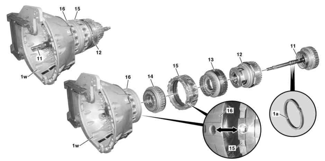

TRANSMISSION 722.9
1a Torlon ring
1w Torque converter housing
11 Drive shaft
12 Front planet carrier
13 Internal plate carrier
14 Multi-disk clutch K1
15 Multi-disk brake B3
16 Multi-disk brake B1
722 589 01 14 00
Sleeve
