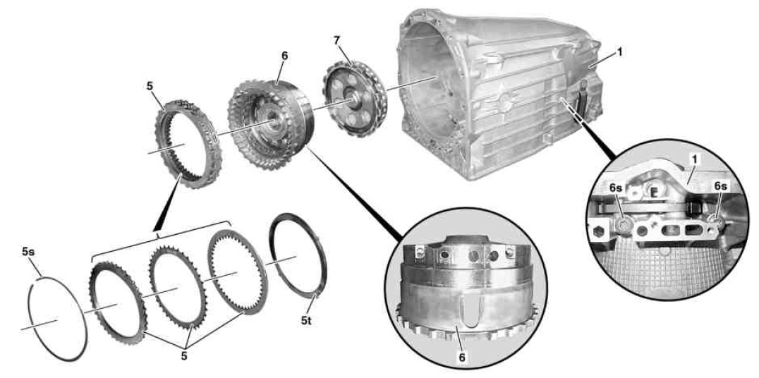

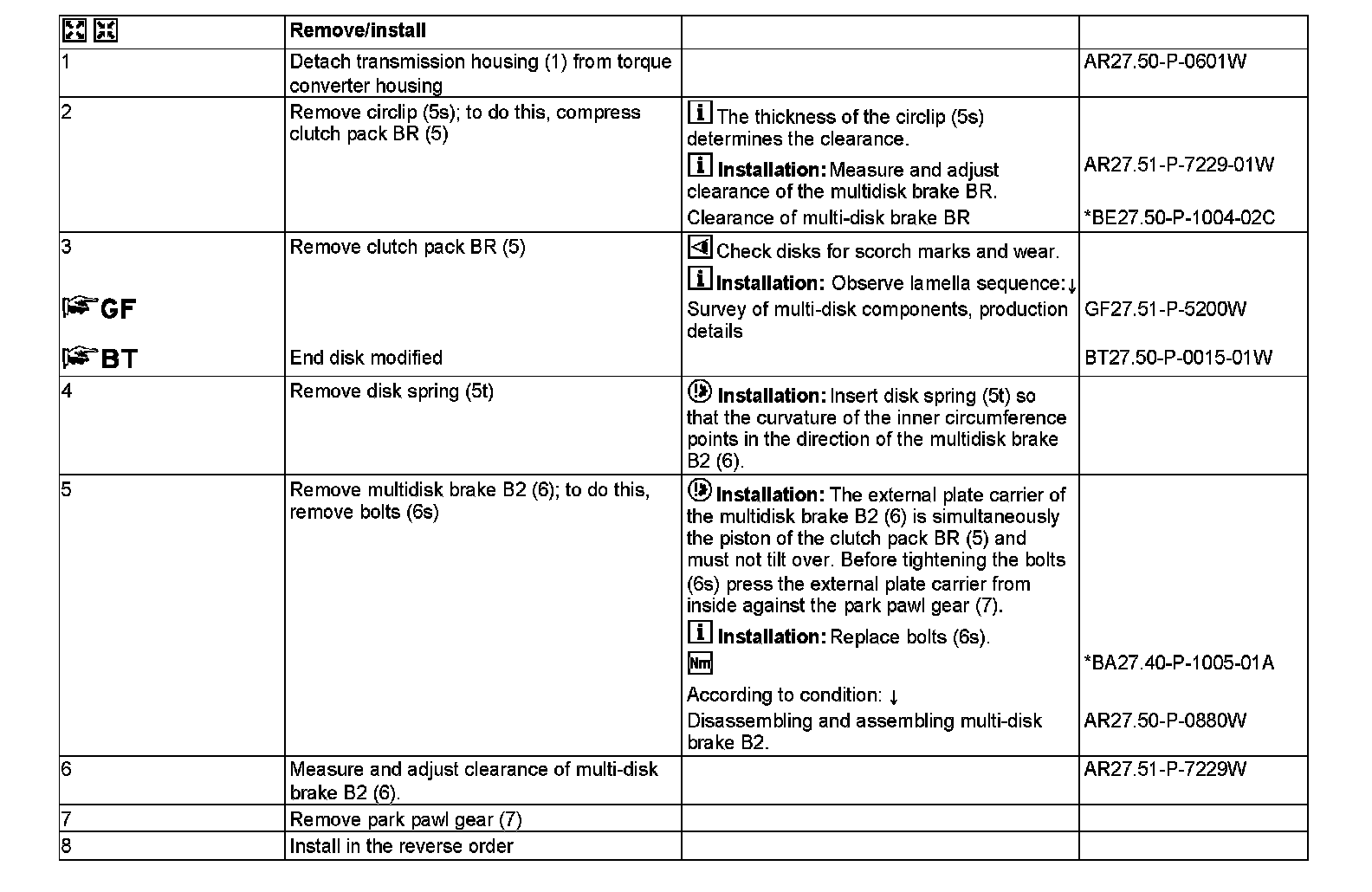

AR27.50-P-0782W Remove/Install Clutch Pack BR, Multidisk Brake B2 and Park Pawl Gear
TRANSMISSION 722.9
1 Transmission housing
5 Clutch pack BR
5s Circlip
5t Disk spring
6 Multidisk brake B2
6s Screw
7 Park pawl gear
