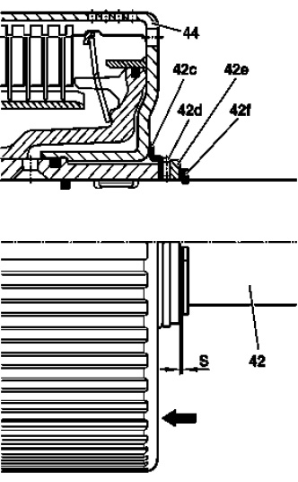

1 Using a feeler gage, check axial play "S" between shim (42e) and circlip (42f).
Push multi-disk clutch K3 (44) hard by hand in direction of arrow.
2 Remove shim (42e) and measure thickness.
3 Adjust play with shim (42e).
Shims (42e) are available in thicknesses 3.1 to 3.7 mm. They are available in graduations of 0.3 mm.
42d Needle roller bearing
42e Shim
42f Circlip
44 Multi-disk clutch K3
