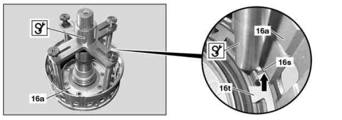

16a External plate carrier
16s Circlip
16t Disk spring

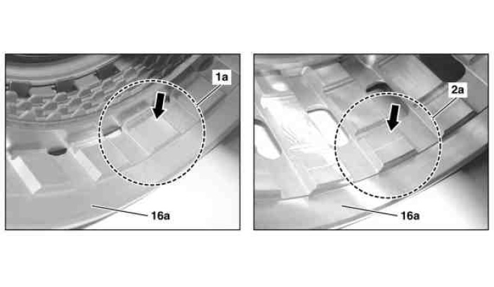

1a External plate carrier without inner phase (old design)
2a External plate carrier with inner phase (new design)
722 589 04 15 00
Set of drifts
722 589 01 31 00
Thrust device
