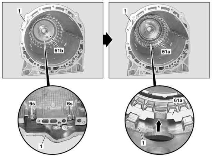

1 Install piston guide (61b) in transmission housing (1) and secure with bolts (6s).
Push piston guide axially into housing to prevent canting while being secured with bolts.
2 Push external plate carrier (61a) into piston guide (61b) as far as it will go.
Recess in gearing and opening in external plate carrier (61a) must face downwards (arrow).
3 Remove preassembled multi-disk brake from transmission housing (1) again B2 to allow further assembly operations to be performed.
