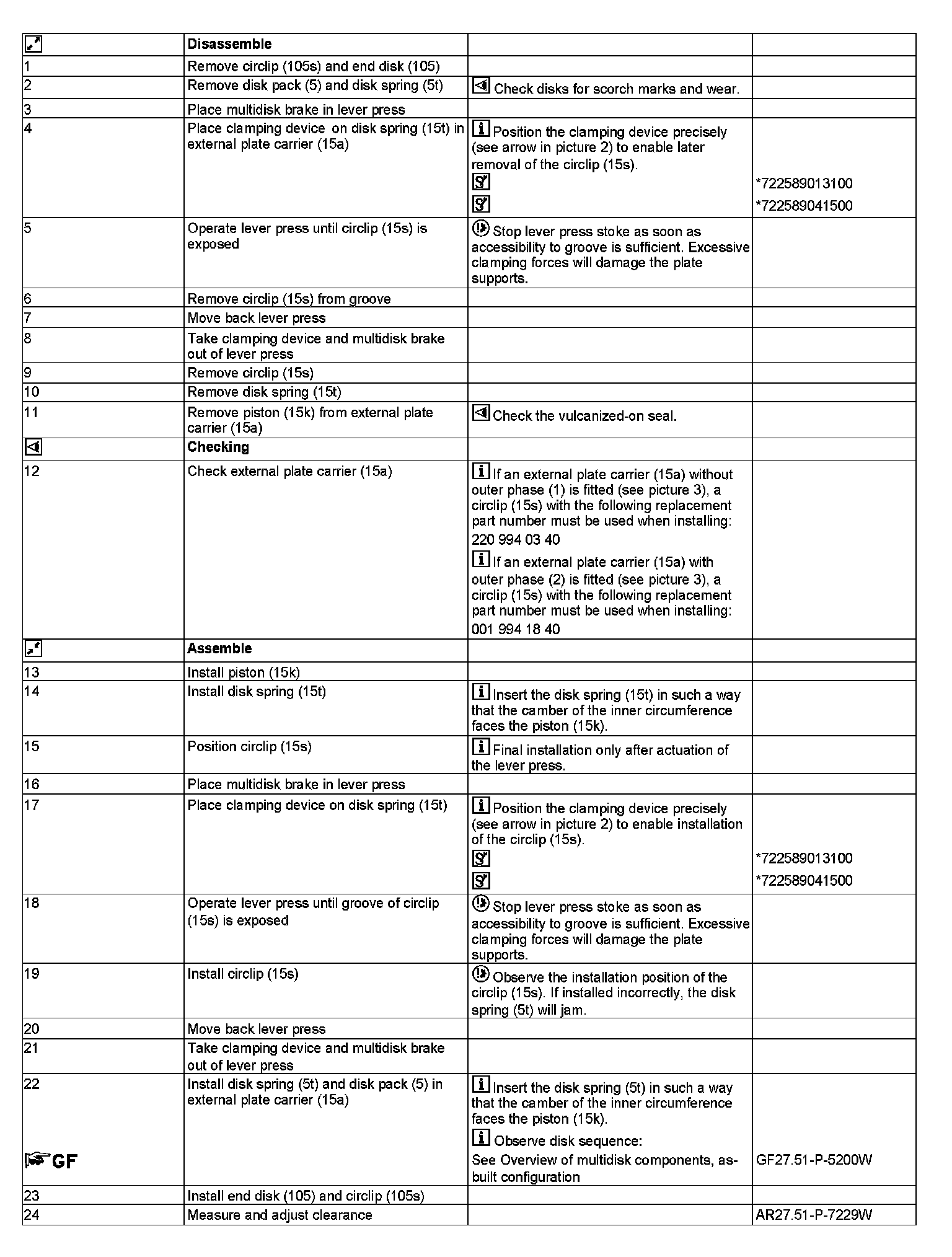

AR27.50-P-0890W Disassemble/Assemble Multi-Disk Brake B3
AR27.50-P-0890W Disassemble/Assemble Multi-disk Brake B3
TRANSMISSION 722.9
5 Clutch pack
5t Disk spring
15a External plate carrier
15k Pistons
15s Circlip
15t Disk spring
105 End disk
105s Circlip

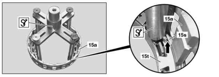

15s Circlip
15t Disk spring
1 External plate carrier without outer phase (old design)
2 External plate carrier with outer phase (new design)
722 589 04 15 00
Drift set
722 589 01 31 00
Clamping device
