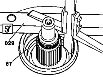

Parallel support
Determine dimension "a"
1 Place parallel support (029) on the transmission housing and measure with the depth gauge from the parallel support (029) to the park pawl gear (15).
Determine dimension "b"
2 Using the depth gauge measure from the parallel support (029) to the contact surface of the grooved ball bearing (67) in the transmission housing.
3 Adjust the axial play "E" by means of shim as per the calculation example.
Example calculation:
Dimension "a" 49,9 mm
Dimension "b" 49,0 mm
Difference 0,9 mm
Axial play "E" -0,4 MM
Shim 0,5 mm
4 Install the corresponding shim.
Shims are available in thicknesses of 0.2 to 0.5 mm. The graduation is 0.1 mm.
