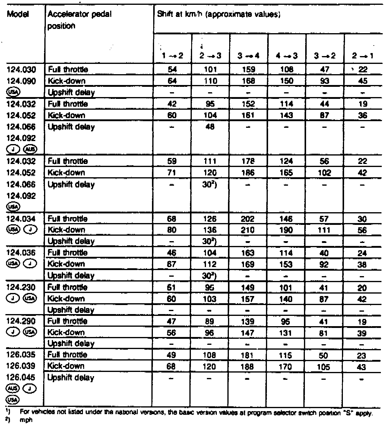

Shift Points In Selector Lever Position "D"
NOTE: All speeds listed are approximate. In each case, they apply to the final drive ratio and tires valid for the model series concerned. Variations from the specified values are due to scattering on the transmission side and in the speedometer display.Vehicles with program selection. Switch position:
E = Economy
S = Standard
Note On Shift Points In Selector Lever Positions "2" And "3"
In vehicles with 6 cylinder gasoline or diesel engines. The 1-2 upshift in driving position "2" occurs only at the maximum engine speed with the accelerator at the full throttle stop. In 8 cylinder engines, the upshift also occurs at part load. To simplify matters, the shift points in selector lever positions "2" and "3" are no longer listed.
Standard Versions
Basic Versions
National Versions
