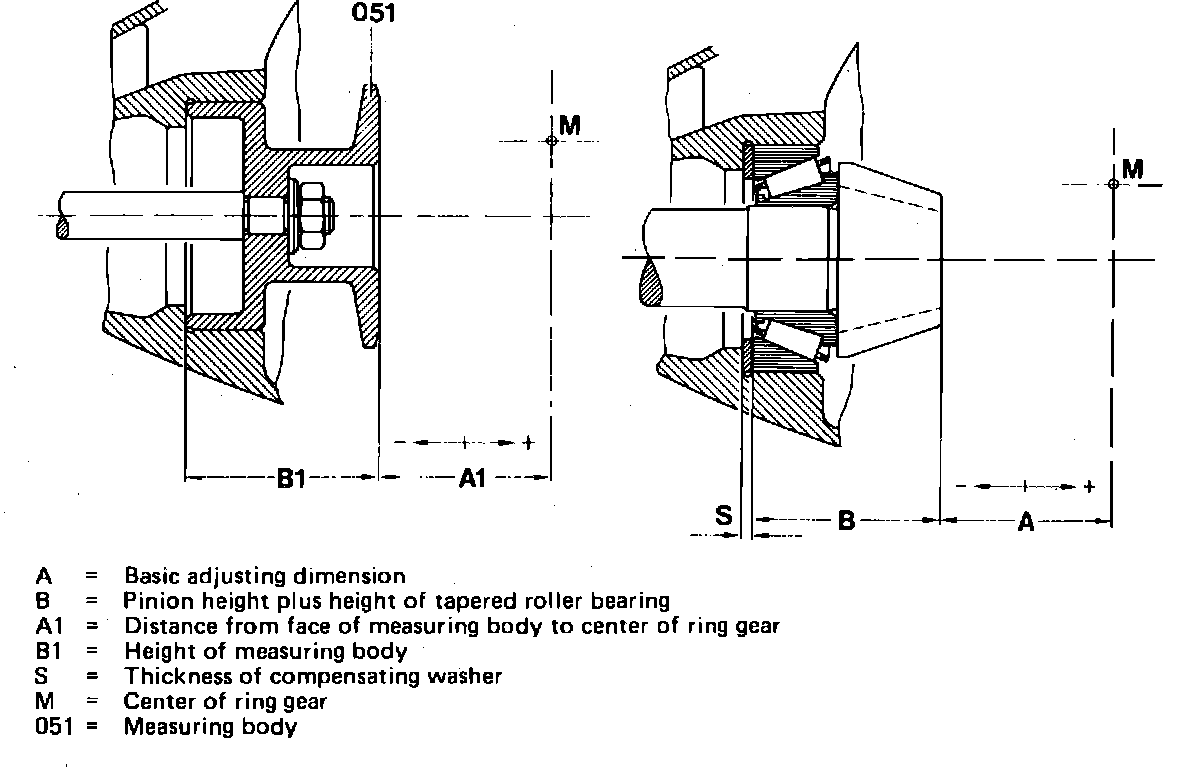

Fig. 4 Measuring Pinion & Measuring Body Height:
1. Check pinion and ring gear run-out to determine compensating washer thickness ``S,'' Fig. 4. Use examples given only as a guide. Example 1, first production model differentials.
a. Determine compensating washer thickness to be used with a small center piece and a drive pinion height of 1.4 inch (37.5mm). The difference between measuring body height ``B1,'' Fig. 4 and pinion height with bearing ``B'' is .055 inch (1.4mm). Allowable pinion deviation, which is stamped on the pinion, is + .007 inch (0.20mm).
b. Add pinion height to allowable deviation, 0.055 inch (1.4mm) + 0.007 inch (0.20mm) = 0.062 inch (1.60mm).
c. Difference between adjusting dimension and rear axle housing ``A1,'' Fig. 4, is +0.002 inch (0.06mm). Add amount computed in step b to the measured value of ``A1,'' .062 inch (1.60mm) + 0.002 inch (0.06mm) = 0.04 inch (1.66mm).
d. Thickness of compensating washer to be installed is 0.064 inch (1.66mm). Example 2, second production model differentials.
e. Determine compensating washer thickness to be used with a small center piece and a drive pinion height of 1.5 inch (39mm). The difference between measuring body height ``B1,'' Fig. 4 and pinion height with bearing ``B'' is 0.062 inch (1.6mm). Allowable pinion deviation, which is stamped on the pinion is + 0.077 inch (0.20mm).
f. Add pinion height to allowable deviation, 0.062 inch (1.6mm) + 0.007 inch (0.20mm) = 0.069 inch (1.80mm).
g. Difference between adjusting dimension and rear axle housing ``A1,'' Fig. 4, is + 0.002 inch (0.06mm). Add amount computed in step f to the measured value of ``A1,'' 0.069 inch (1.80mm) + 0.002 inch (0.06mm) = 0.071 inch (1.86mm).
h. Thickness of compensating washer to be installed is 0.071 inch (1.86mm).
