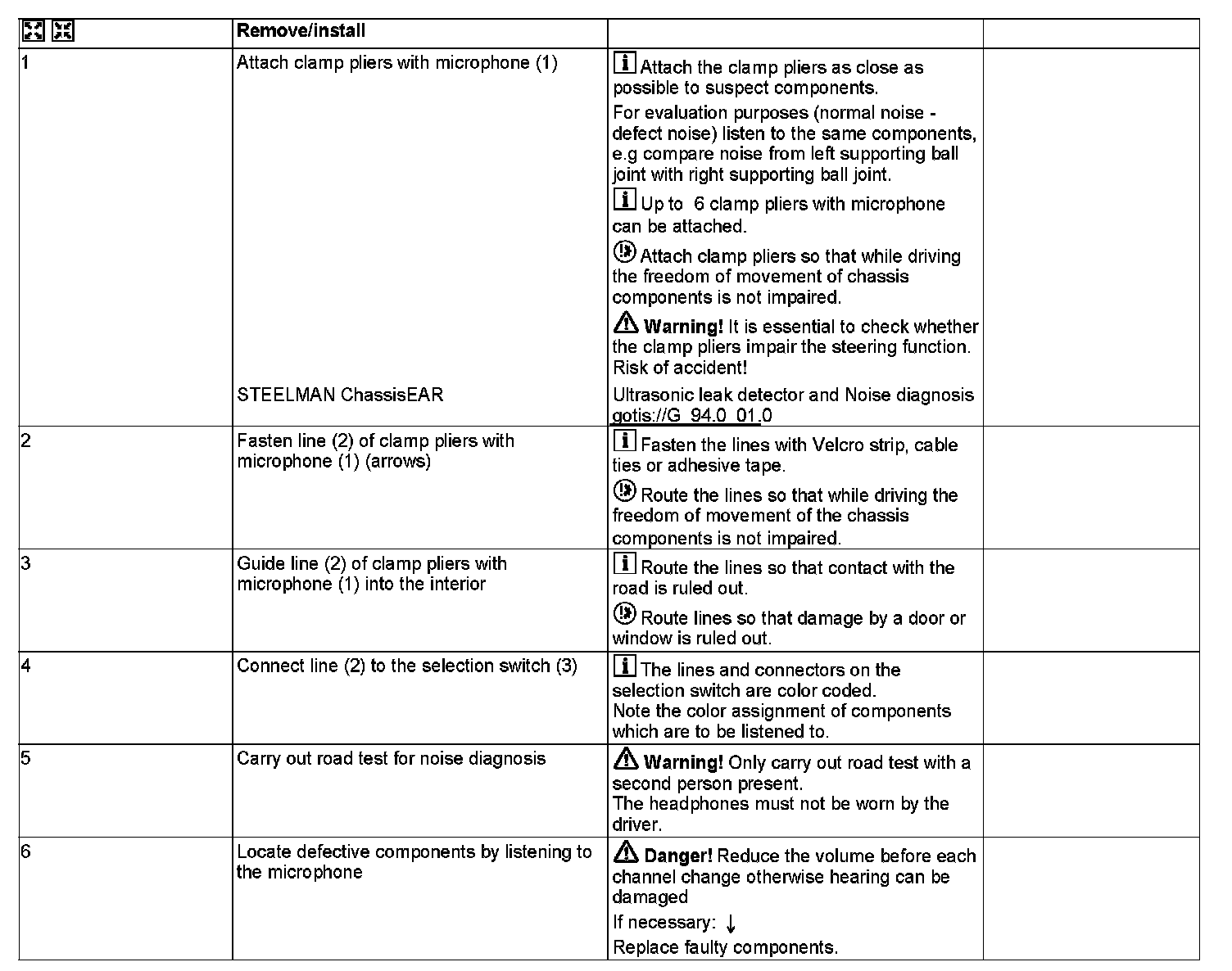

AR33.00-P-2000A Locate Noises From the Front Axle
AR33.00-P-2000A Locate Noises From The Front Axle
MODEL all
Example shown on model 204
1 Clamp pliers with microphone
2 Cable
Example shown on model 211 front axle
2 Cable
3 Selection switch
