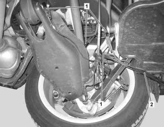

Example shown on model 204

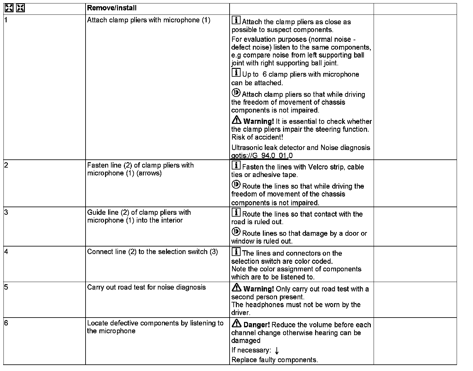

1 Clamp pliers with microphone
2 Cable
Example shown on model 211 front axle
2 Cable
3 Selection switch
