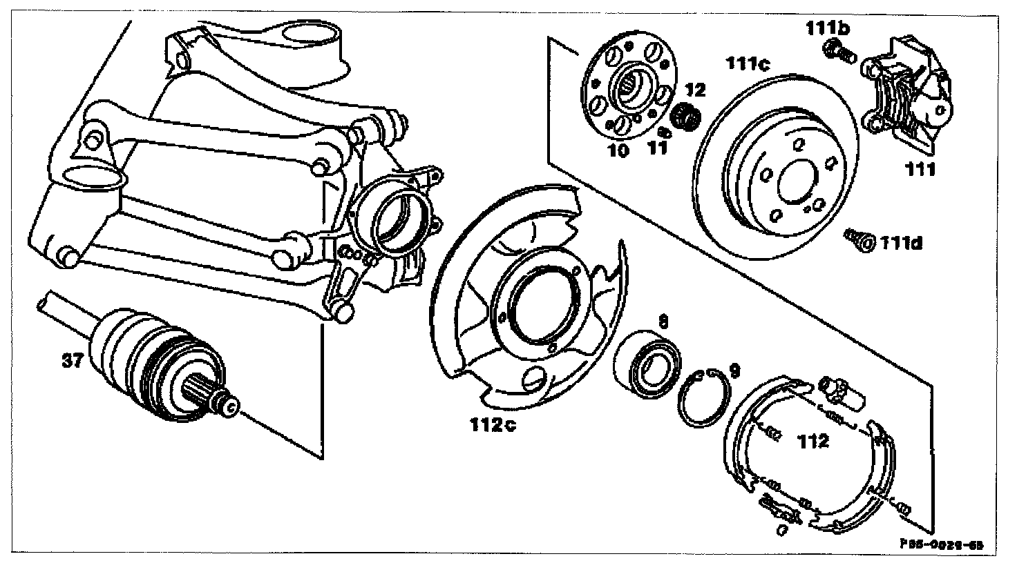

Removal & Installation of Rear Axle Flange With Angular Ball Bearing
Preceding work
Remove, install wheels
Special tools
Note Work can also be carried out on the mounting of the rear axle shaft flange when the rear axle is installed.
7 Wheel carrier
8 Two-row angular-contact ball bearing
9 Circlip
10 Rear axle shaft flange
11 Parallel pin
12 Twelve-point collar nut
37a Rear axle shaft
37b Outer joint race
37d Joint hub
37e Ball
37f Ball cage
37g Circlip
37k Hose clamp
37l Rubber cup seal
Removal, installation

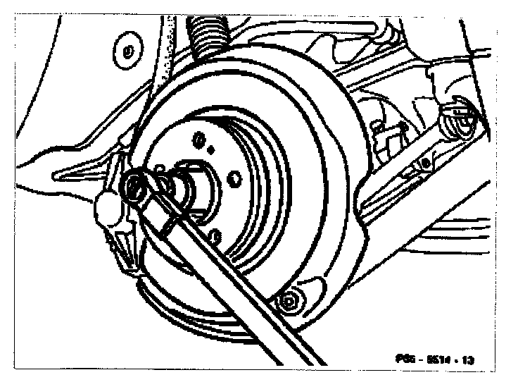

1. Remove, install rear axle shaft, refer to Drive Axles, Bearings and Joints - Axle Shaft Assembly - Axle Shaft - Service and Repair - Procedures Service and Repair
2. If it is tightly seated, use extractor/pulling-in equipment 140 589 03 61 00 to press rear axle shaft out of rear axle shaft flange.

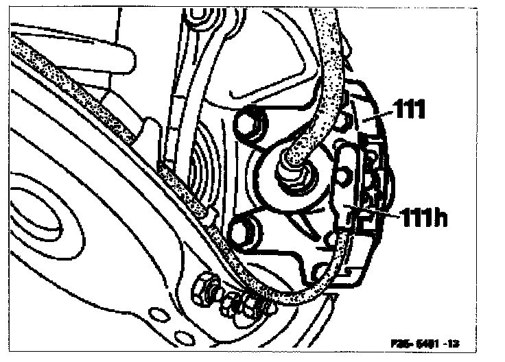

3. Remove, install brake calliper (111) and suspend on a hook, refer to Brakes and Traction Control - Disc Brake System - Brake Caliper - Service and Repair - Procedures Service and Repair
Installation note
Replace self-locking hexagon bolt. Install brake hose and, on vehicles with ASR, install electric cable of wear indicator (111h) without twisting.

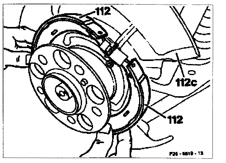

5. Remove, install brake shoes (112) of parking brake.

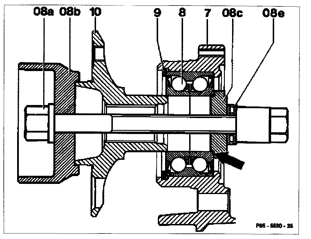

6. Using extractor/pulling-in equipment (010) 140 589 03 61 00 with set bolt (010b) and thrust piece (010a), pull rear axle shaft flange (10) out of angular-contact ball bearing (8) and remove.
Installation note
Using extractor/pulling-in equipment (08a, 08b, 08c and 08e) 124 589 05 43 00 draw rear axle shaft flange (10) into two-row angular-contact ball bearing (8).
Caution:
During the pulling-in process, the thrust washer 124 589 05 43 00, part 03 (08c) must fit tightly against the bearing inner race (arrow). In the case of the two-row angular-contact ball bearing, use the thrust washer side of 45 mm dia. (smaller dia.) and in the case of the two-row angular-contact roller bearing, use the thrust washer side of 49 mm dia. (larger dia., Tmodel only).

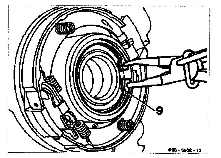

7. Remove circlip (9) from wheel carrier using circlip pliers 126 589 00 37 00.
Installation note
Ensure correct seating of the circlip in the wheel carrier.

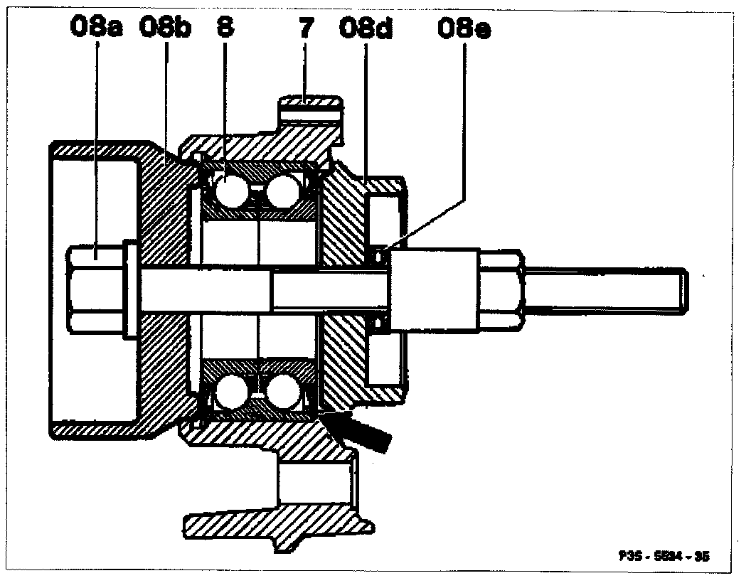

8. Using extractor/pulling-in equipment (08a, 08b, 08c and 08e) 124 589 0543 00, pull two-row angular-contact ball bearing (8) out of wheel carrier (7) and remove.
Installation note
Using extractor/pulling-in equipment 124 589 05 43 00 (08a, 08b, 08d and 08e), pull two-row angular-contact ball bearing (8) into wheel carrier (7) until this contacts the edge (arrow).
