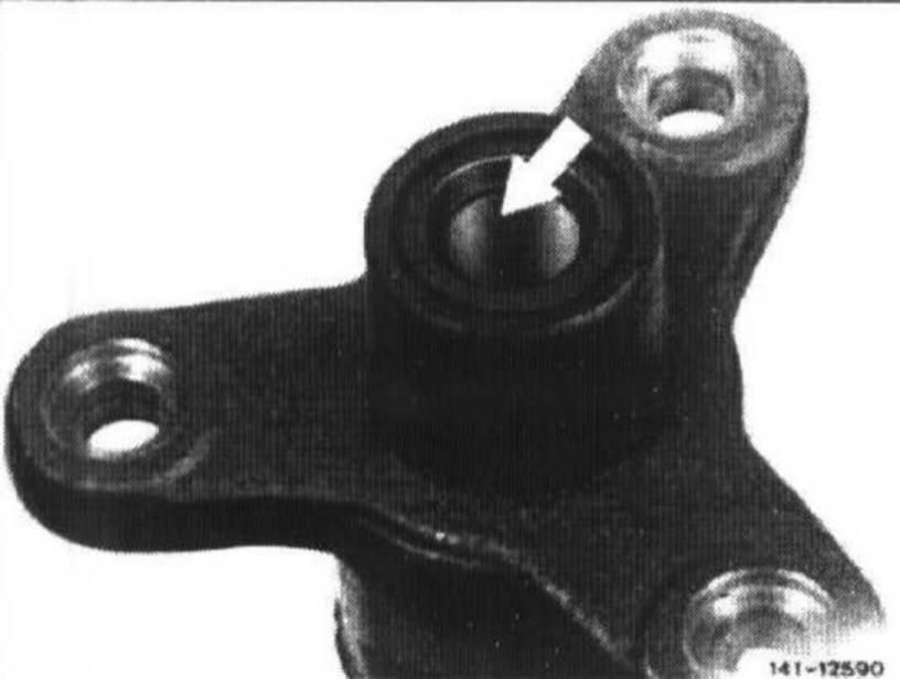

Note: In the event of wear or damage to sealing lip in centering sleeve (10) of front or rear propeller shaft, the centering sleeve can be individually replaced.

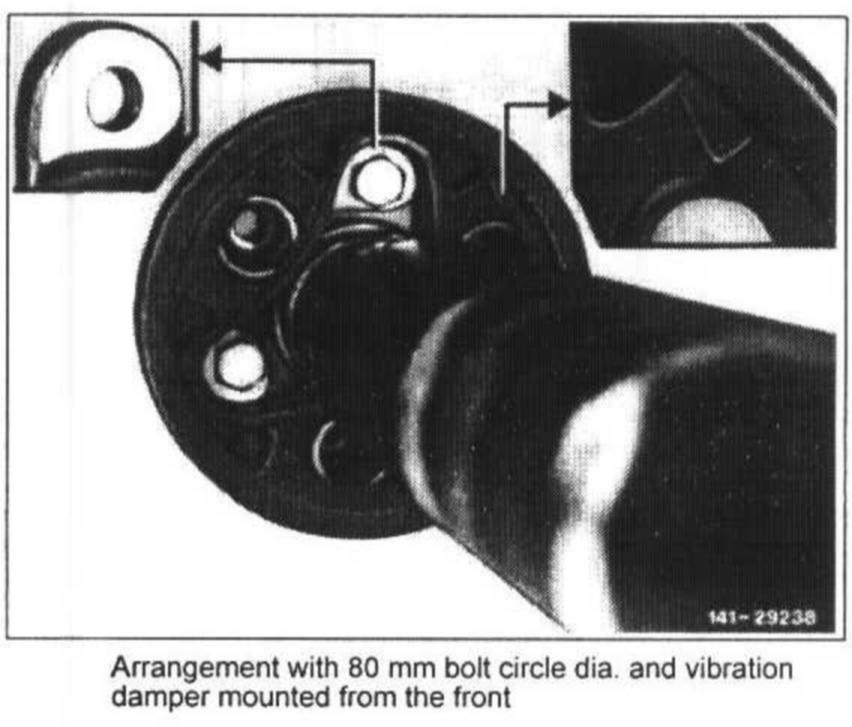

2 Unscrew hex. socket or hex. head screws with self-locking hex. nuts. The installation position is correct, if the vulcanized arrow on vibration damper points to hump of three-legged flange (arrows). Renew self-locking hex. nuts. Tightening torque M10 = 45 Nm, M12 = 65 Nm.
Installation note: The installation position is correct, if the vulcanized arrow on vibration damper behind hump is mounted on three-legged flange (cutouts). Replace self-locking hexagon nuts; Tightening torque 40 Nm.
3 On propeller shafts without vibration damper, be sure to mark the flexible coupling in relation to three-legged flange of propeller shaft.
4 Soft pull-push flexible coupling (soft pull-push) according to lettering "DIESE SEITE ZUR GELENKWELLE" (THIS SIDE TOWARD PROPELLER SHAFT).
5 On vehicles with soft pull-push flexible coupling (soft pull-push) loosen the vulcanized fitted sleeves out of three-legged flange. For this purpose, use a cylindrical mandrel of 10 mm dia. and approx. 150 mm in length.
6 Remove flexible coupling and, if installed, vibration damper.
7 Separate front propeller shaft from rear propeller shaft. Front and rear propeller shaft are marked in relation to each other. When joined, make sure that the hump on front propeller shaft is located in center of the two arrow-Modele humps of fork- Modele joint (arrows).
