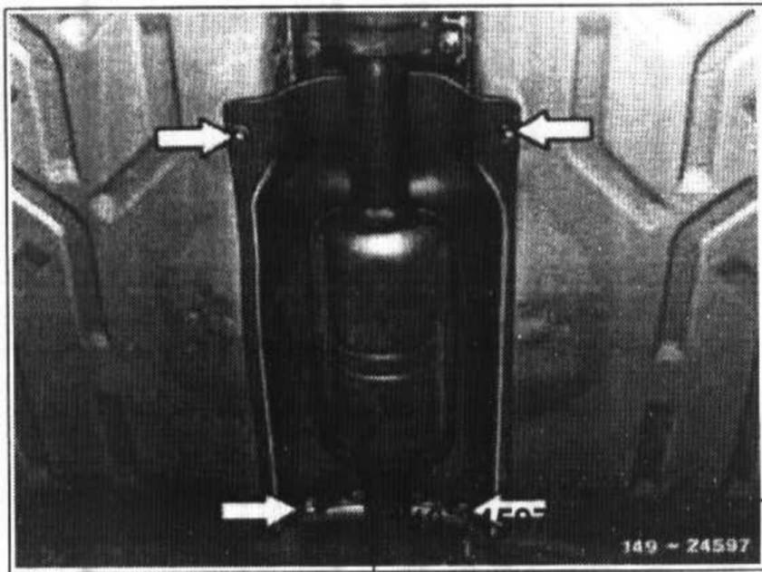

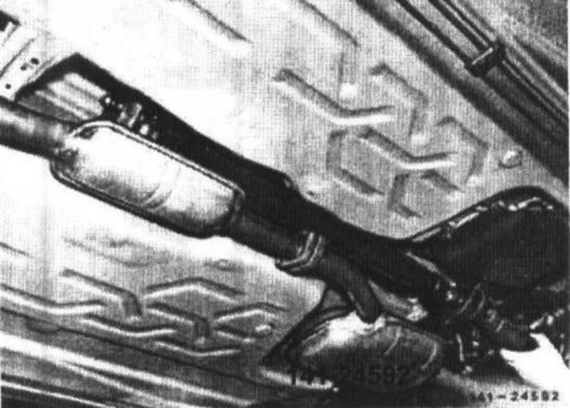

1 Unscrew exhaust shielding plate (arrows).
4MATIC
2 Unscrew exhaust shielding plate.

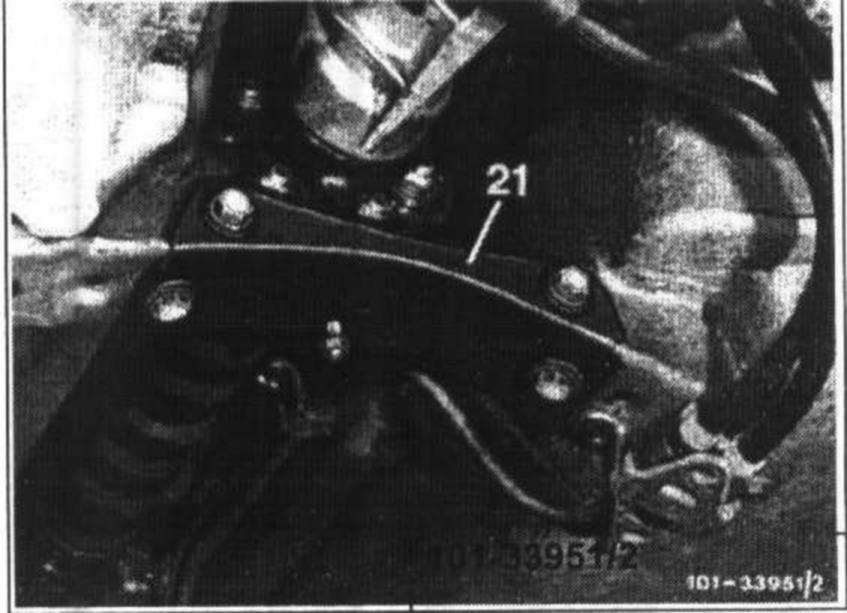

5 Unscrew cross bridge (21). Tightening torque 25 Nm.

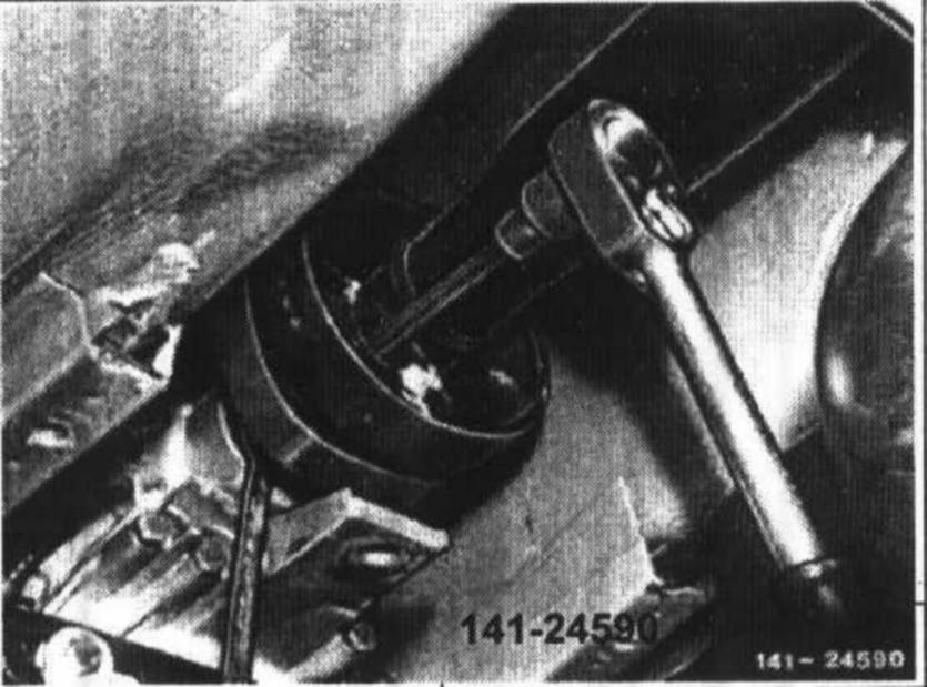

6 Loosen propeller shaft clamping nut (3) for approx. two turns without sliding back rubber sleeve (sliding along). Tightening torque 30 - 40 Nm, while paying attention to correct seat of rubber sleeve.

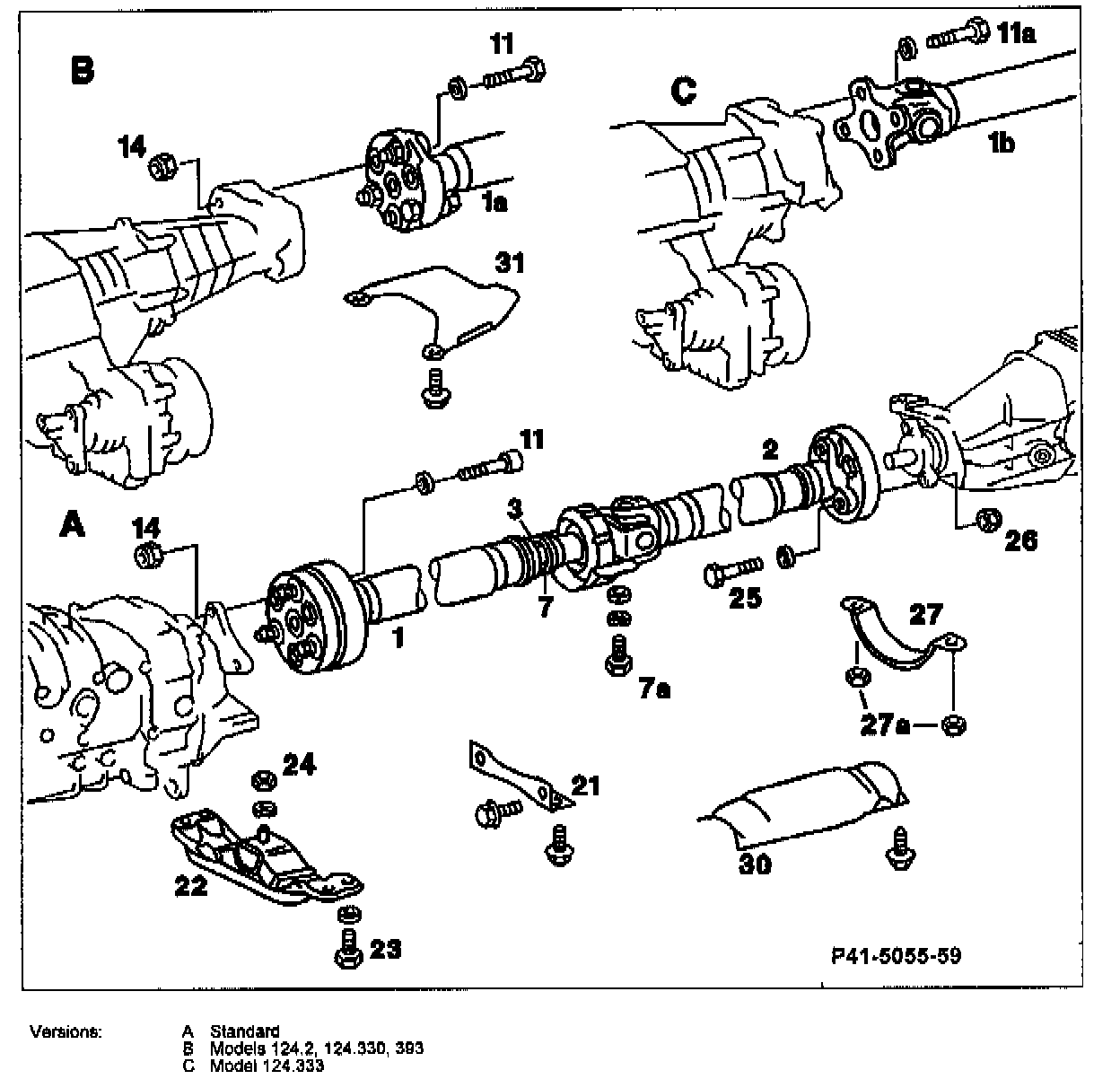

Installation note: Renew self-locking hex. nuts. Tightening torque M 10 = 45 Nm, M 12 = 60 Nm.

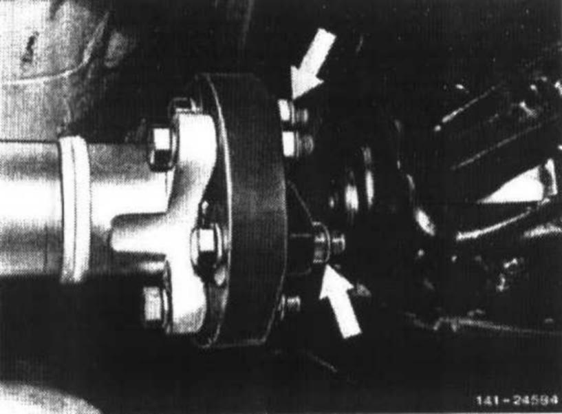

10 Remove propeller shaft from rear axle (arrows).
Note: Flexible coupling remains on propeller shaft.
11 Unscrew hex. head screws (7a) of propeller shaft intermediate bearing on frame floor. Tighten hex. head screws only after fastening propeller shaft to transmission and rear axle, tightening torque 25 Nm.

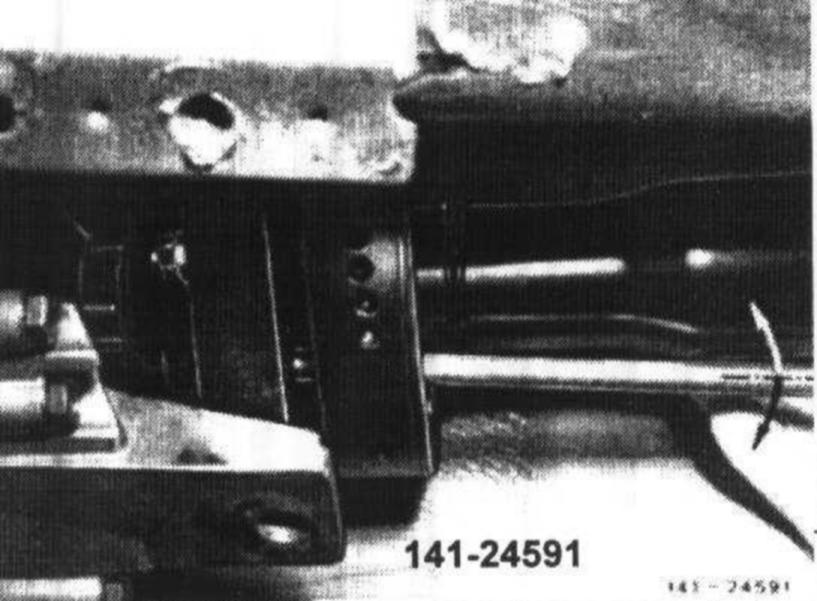

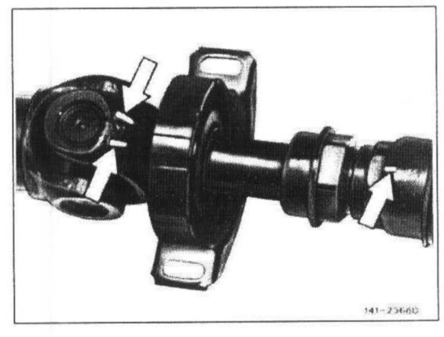

13 Force propeller shaft from centering pin on transmission and rear axle and remove toward the rear.
Caution! If a separation of the propeller shaft is required, reassemble the parts again as shown. The front propeller shaft is provided with a hump and the fork-type joint of the rear propeller shaft with two arrow-type humps. The hump of the front propeller shaft should be located between the two arrows on fork-type joint (arrows).

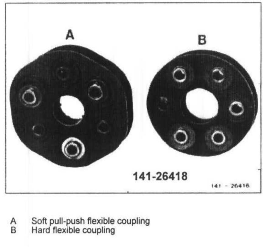

14 Check flexible coupling, centering sleeves, vibration damper
Note: A soft or hard pull-push flexible coupling (except on models 124.333/393) is installed on the transmission and a hard flexible coupling is installed on the rear axle.

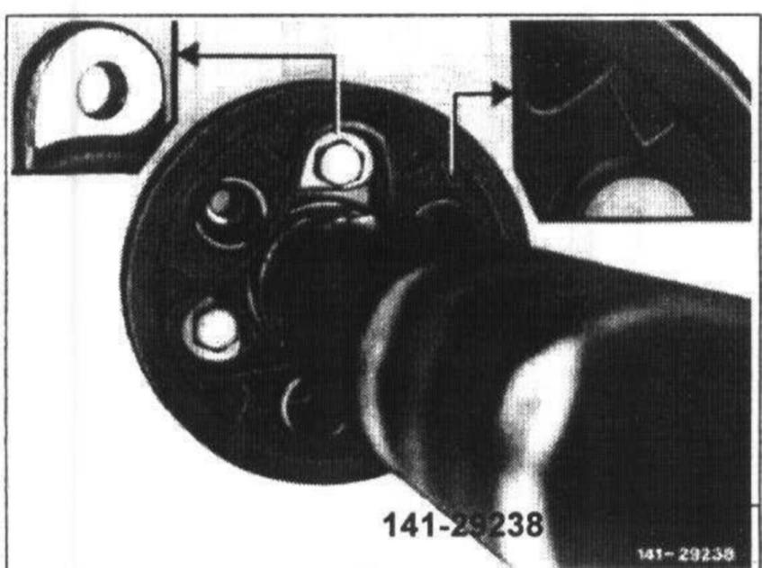

Marking On 2nd Version As Of 1/90:
16 Model 124 with a bolt circle diameter of 90 mm. The installation position is correct when the arrow of vibration damper points to hump on three-legged flange.
