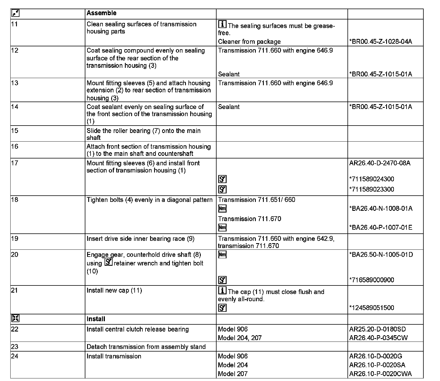

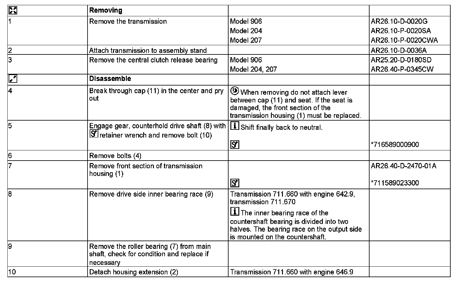

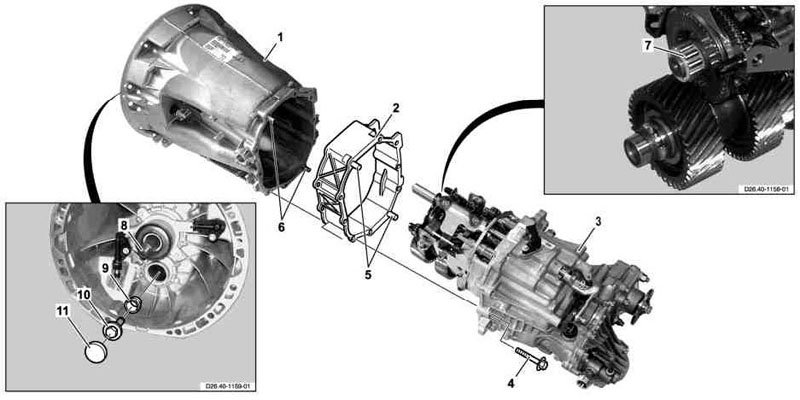

Shown: Transmission 711.660 with housing extension
1 Front section of transmission housing
2 Housing extension (only transmission 711.660 with engine 646.9)
3 Rear section of transmission housing (with gear set)
4 Screw
5 Fitting sleeves
6 Fitting sleeves
7 Roller bearing
8 Drive shaft
9 Inner bearing race (only transmission 711.660 with engine 642.9, 711.670)
10 Screw
11 Cap
124 589 05 15 00
Drift
711 589 02 33 00
Extraction tool
711 589 02 43 00
Insertion tool
716 589 00 09 00
Retainer wrench
