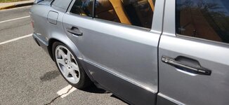

This is, uh, interesting. AutoCheck is filled with "Not Actual Miles" tags starting in 2001 at 49kmi. Why were the seat covers replaced with such low miles? And, in a non-factory color. 😿

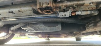

Pity about the serious rust problems (note exhaust heat shield is gonzo) and the interior color change. No hood pad. $43k ask seems entirely odometer-based, surrounded by DDD. Sagging headliner. No spare wheel/tire, why? Paint is fried everywhere. Rear end sits low enough that I wonder if SLS was deleted too.
Anyone interested in this car, would be wise to pay for a detailed PPI...

I love the color …. But shudder at the potential cost of bringing this up to casual concours condition. (Meaning concours enough for a Legends of the Autobahn). 😕
The photo below says a lot.
Isn't that the piece they had black tape over?? This is giving me "barn find" vibes, except it was parked in a field under a tree with no barn. "Rodents" may be the answer to your question about why new seats at 65k miles.
I would not touch it at half that.
Dave's 100% correct -- $40K to do the paint and before rust remediation, but that does not include interior, IMHO.
There there's mechanical...
This is a disease on 4 wheels...buying someone else's troubles. The ad copy alone is enough to scare me off.
