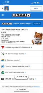

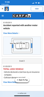

hi, i am interested in this car but i am
unable to travel to see the car for myself, can i ask if you don’t mind to take a look at the car, i spoke with the seller when he posted the car the first time but he took the post down because he didn’t had the title, now he told me he has the title but i wanted to chek it out because the car was a total loss and its rebuilt and i wanted to see if it was properly repaired
here are some screenshot from the carfax
this car has 2 accidents one declared the car totaled
