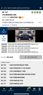

SOLD 1992 500E, Repaint 040 Black/Black, 200kmi+ TMU, BaT auction (Roswell, GA)
gsxr
No affiliation. This car sold weeks ago at Manheim Dallas for $33,250 plus fees, plus transport to GA. Dealer is probably in it for $38k+ and expects a profit on top of that. Thanks @benzgarden for the background info! 🙏
Major Red Flag: Besides the non-stock color on the speedometer, it has been replaced with a non-ASR 400E/E420 instrument cluster, and it has a MAJOR rollback. In 2022 this car had 195kmi on it. Probably has around 200k now. Selling with 75k is massive fraud. 😠 I was going to say the car looked like it had more wear than it should with 75k and yep, AutoCheck / Carfax confirms it.

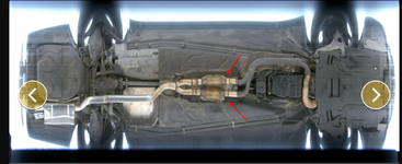

Also, the heat shield has completely rusted off the catalyst pipe... and it has aftermarket cats. [It almost certainly will not pass CA emissions testing until CARB-approved catalysts are installed.] Strong possibility of rust elsewhere on the car, since it appears to have been sold new around NY, and later spent time in MN.
UPDATE: The headlight lenses are left-hand-traffic (UK/Japan/Australia), but appear to be E500 lenses. No way to tell if the headlights themselves are LHT or not (the reflectors are different vs RHT). The passenger side headlight appears to have a failed gasket/seal, and the lens has condensation internally, which means the reflectors may corrode quickly if this isn't fixed immediately. AND, the driver side headlight has 1 broken retaining clip. There are no good photos of the headlights with the hood up to check for additional broken clips. The plastic clips are part of the headlight bucket/assembly and are difficult (nearly impossible) to repair. The lights DO appear to be correct 036 headlights (no shield over H3 bulb) but again, unknown if the reflectors are LHT or RHT.
Oh, plus accident history which might explain the full facelift... and the color change from 199 to 040.
VIN = WDBEA36E9NB692308

Is the current seller the dude/dudette who rolled the odo back by a ridiculous amount? If so, then let's hope all prospective buyers find your post, @gsxr!
No, the current dealer just acquired the car about a month ago.
The odo rollback occurred at least a year ago, maybe longer. See the CarFax screenshot in post #2 above. The rtollback happened between late 2022 and early 2025. The previous owner may or may not have known about this.
:detective:
That sucks for the current seller.......thankfully these cars don't care about miles, as long as they are well maintained, so it might still be a nice car for someone as long as there is a stack of maintenance receipts
Yup. Current seller was warned ahead of time, IF they read the Manheim auction details - see below.
"Collector owned" my ass. Collectors don't own stuff with 200kmi and 5 owners. :rolleyes:
Buyer beware, even dealers buying at auction. I wonder if this dealer got starry eyed over the odometer and somehow missed the CarFax report? If so, how embarrassing for them.
I just noticed the entire instrument cluster was replaced with a non-ASR 034 cluster. This means no ASR warning triangle to alert you when ASR detects wheelspin, and no ASR fault indicator light either.
And, the headlight lenses are LHT. Driver headlight has 1 broken retaining clip. Catalysts are aftermarket. I updated the first post with details.
The dealer should have replaced the cluster with an ASR cluster from an 034 and rolled the odo forward to 200kmi before listing on BaHaT. Then it would have been a "mileage inconsistency" reported in 2024. As it sits, this is blatant fraud... I'm amazed / shocked / disappointed Manheim sold it like this in the first place.
