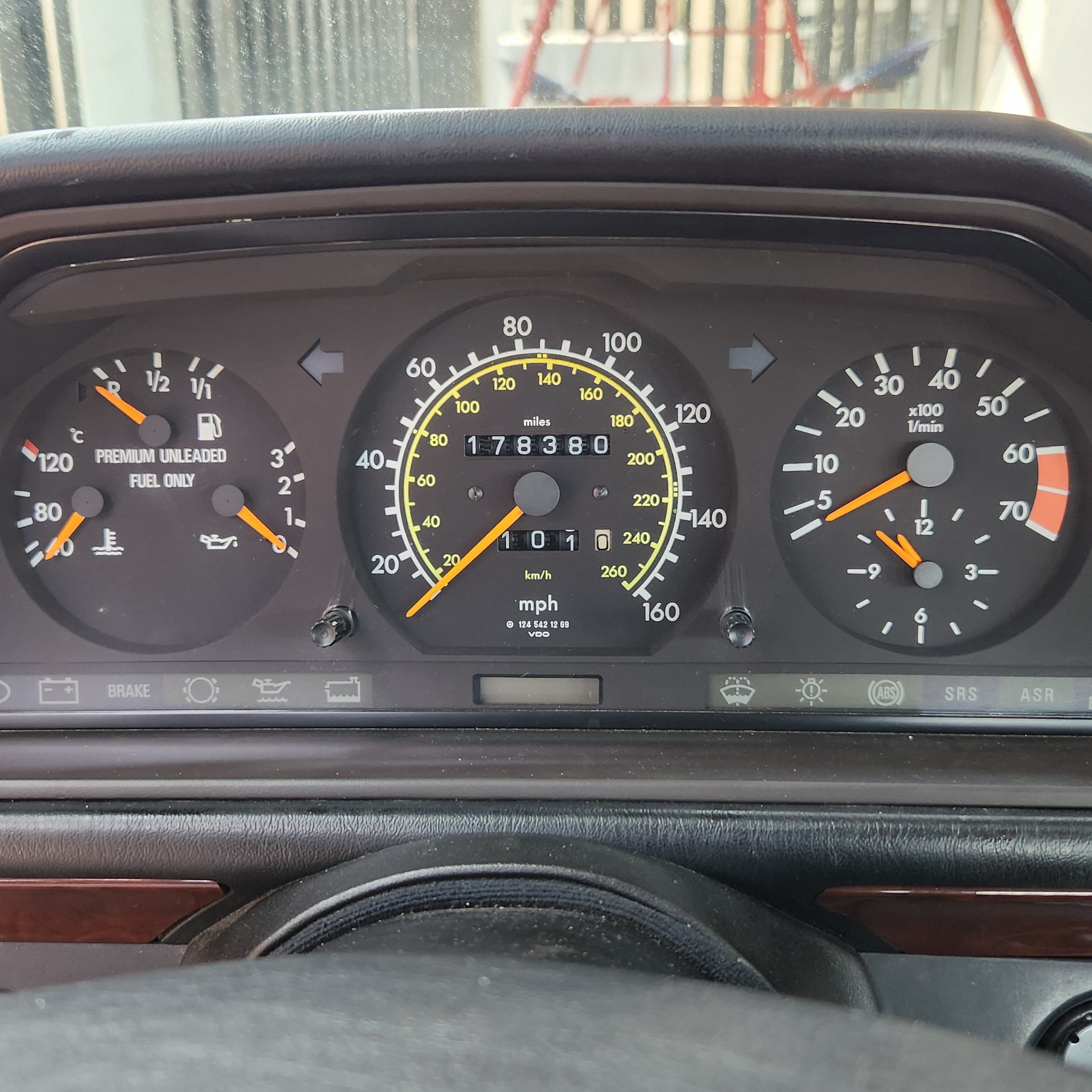

Gerry, my car does have a incorrect non-ASR speedo from another W124. My E500 was built in 11/93. What would be the correct part number? Thank you

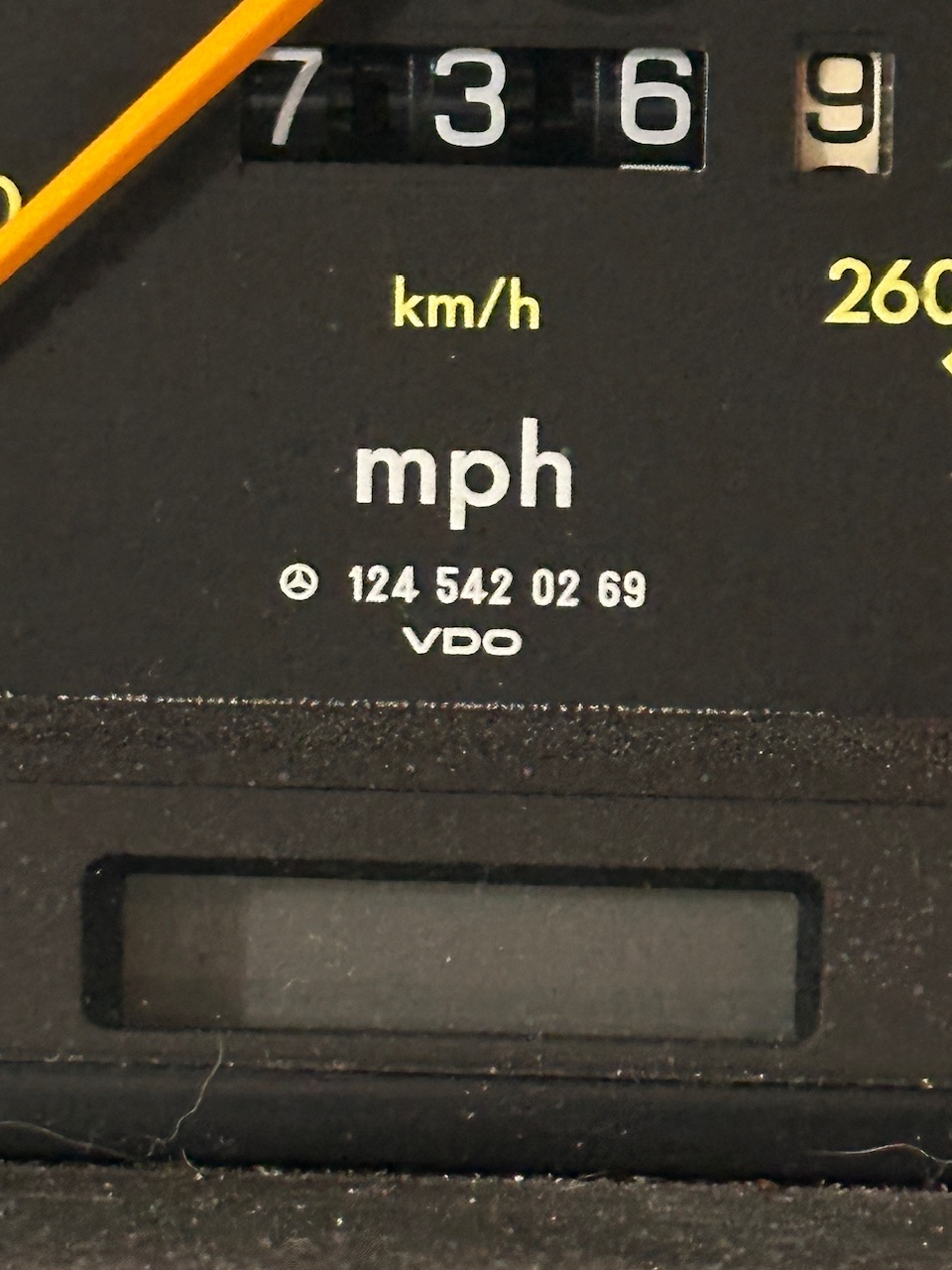

My E500 was made in September of 1993, and the speedo part number is 124 542 02 69.
Photos attached.

Gerry, not sure what my original speedo part number was but the non-ASR replacement is 124 542 12 69. I may have to opt for a 400/420 replacement w/ASR if I can find one. Our storage area was broken into, trashed and auto parts and motorcycle parts are missing. The intact original binnacle with E500 speedo may have been taken in the theft.
