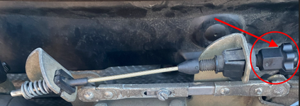

So it looks like I have a connecting bar rather than a connecting rod. I still measured 134mm, I wasn’t far off at all but I cleared codes again on pin 7 to see what happens. Thanks again!
That bar in your photo will adjust the transmission control pressure (Bowden) cable. Move it a few mm in either direction and your shift RPM changes.
The throttle cable adjustment is made by turning the knurled collar on the driver side:
Make sure there is some play at the very end by the spring. The cable should not be pulling on the lever at all, in the idle position.
