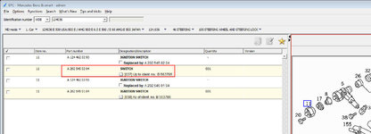

I don't have an access to EPC at the moment so Can someone give me a correct part number for ignition switch. Is that part number correct for my car which nocfn, gave in post #2? Car VIN is 1240361B549704.
I made few part queries for dealers and aftermarket part suppliers and their prices for ignition lock switch variables between 35 - 110 euros and they are not sure is it correct part for my car..
here is a data card for you, and the ignition switch with the superseded p/n. either will work.
Hmm, finally have access to EPC and I search for that ignition switch. My EPC will give a part number A202 545 02 04 for that ignition switch. I have ordered A202 545 01 04 ? Any idea is those parts interchangeable? Ordered part has not yet arrived. Or have I bought the wrong part?
Then is it necessary to remove whole steering lock assembly to replace ignition switch? Should I also take instrument cluster out for having more space to work with? :confused:
Based on your VIN, your car needs the early switch (to chassis B563785) which is p/n 202-545-02-04 .
Late chassis (as of chassis B563786) uses p/n 202-545-01-04.
If your chassis is B549704 then it appears you have ordered the wrong switch.
