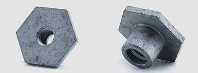

That nut on top of the rubber mount is #102 094 00 72
:banana1:
@500AMM, thanks! I've had anchor points for 2 months before I got "inspired" to search out what I was missing: the nut on top of the rubber mount. A few days ago I've fixed them. Something like $17 per nut at a local dealership - just did not want to wait. Out of 3 dealerships in my area, only 1 had only 2 in stock 🙂
