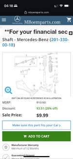

Two days later, after ordering four Lemforder offset bolts from FCP, I wanted to investigate why the camber angle won't change.
I got under the car and loosened the two offset bolts holding the lower control arm. The front one mainly change the camber while the rear one could also change the toe. I pushed the lower control arm as far out as possible to get the maximum negative camber I can get. I could confirm that the offset bolts are fine. The new order from FCP will be spare parts.
After that, the car was way off. The steering wheel was off and the car pulled to the right side worse than before. I am not surprised because the random camber adjustment I did.

So, I paid over $11 each at FCP while the dealer only charges $10. it is Lemforder, not any lousy ones. And then after a week, it was discounted to $8.00 after I bought it, four of them. $12 in loss?!!!! I will go bankrupted at this rate.
