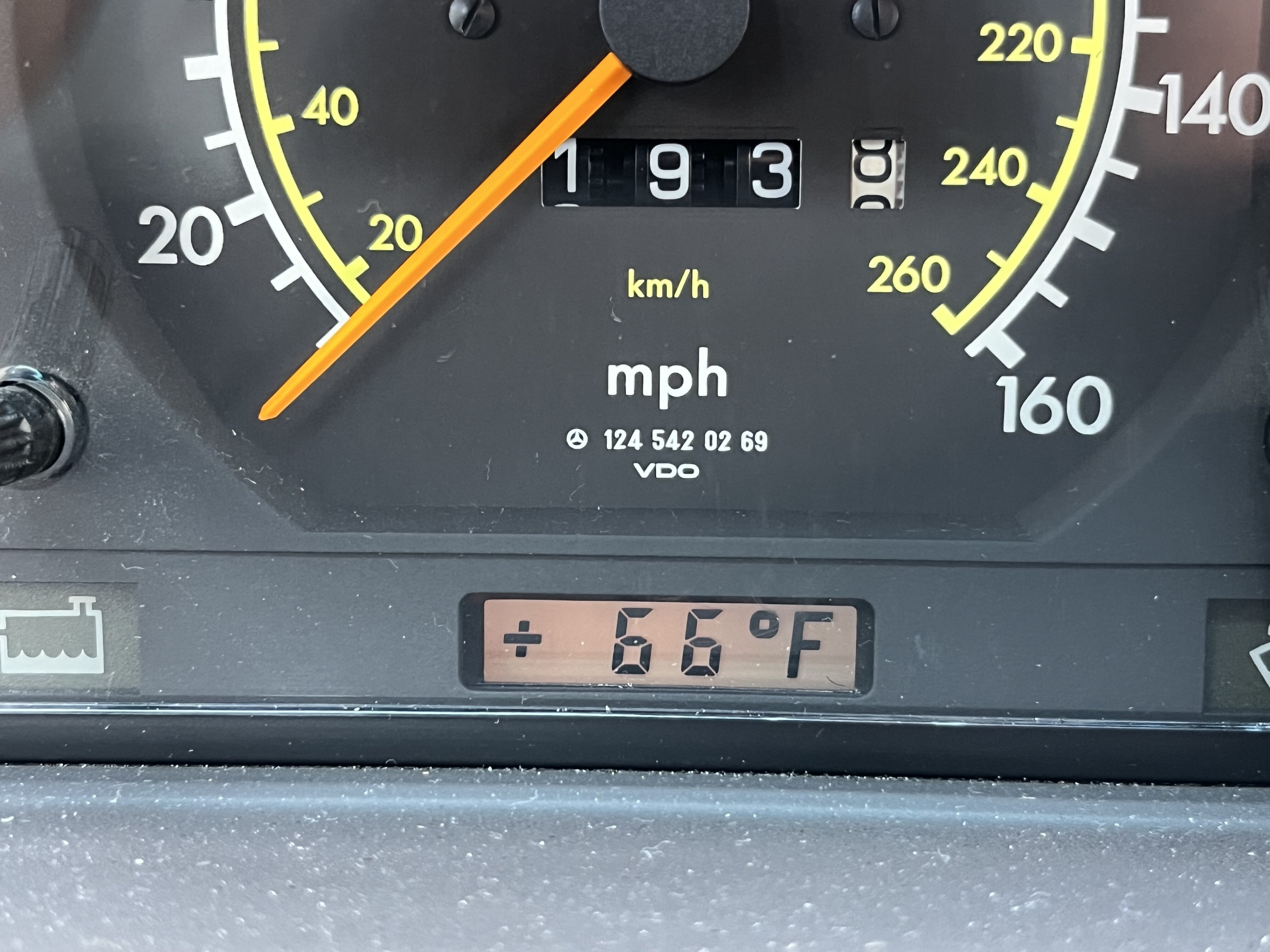

Have traced issue with ambient temperature gauge reading accurately then 20 degrees below actual temperature to unit in dash

You probably got sold one from a 126 instead, which is a bit larger than the 124 unit and doesn't fit into the 124 instrument cluster. Either that or as the @gsxr mentioned, there is a different connector for the first couple of years of the W124 before they transitioned to an identically sized but electrically more advanced unit.
Just looked at what was sent.
5 pins and thinner display than what is on my dash.

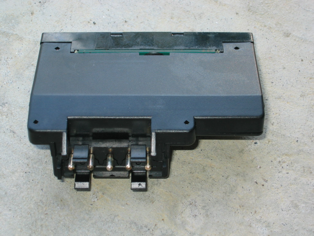

:update:
Here is a photo of a proper five-prong unit that will fit into any E500E, taken from my linked thread:
