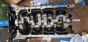

Some photos of the parts of the original AMG 6L rotating assembly (all own photos) :

Makes sense--I guess the uniform nature of the marks would indicate they're from an intentional process. I just haven't ever seen such marks on a crank before!
Here another one from a 2.5-16 M102.990 engine, same inductive hardening marks:
I have more pictures if needed since a number of engines and cranks went through my hands.
