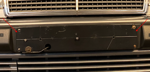

Very Nice. I like the euro plate look, thatll mount right to the impact bumper strip correct? Or i still need an additional adapter?
Great to speak with someone knowledgeable with this cars.
The blank filler panel, and/or license plate bracket, both require metal mounting rail 1248850921 plus 4 short mounting screws. The plastic panels slip into the metal rail, and then attach with 4 more (longer) screws.
I'm not familiar with the Euro license plate mounting details but it appears mounting bracket 1248851023 would be recommended, although it should be possible to attach the license plate directly to the impact strip? Maybe? Or there might be an aftermarket bracket. Forum members in Europe can probably provide more specifics. I've never mounted a Euro plate.
:tumble:
Im not familiar with the Euro license plate mounting details but it appears mounting bracket 1248851023 would be recommended, although it should be possible to attach the license plate directly to the impact strip? Maybe? Or there might be an aftermarket bracket. Forum members in Europe can probably provide more specifics. Ive never mounted a Euro plate.
:tumble:
I mounted mine directly to the impact strip
